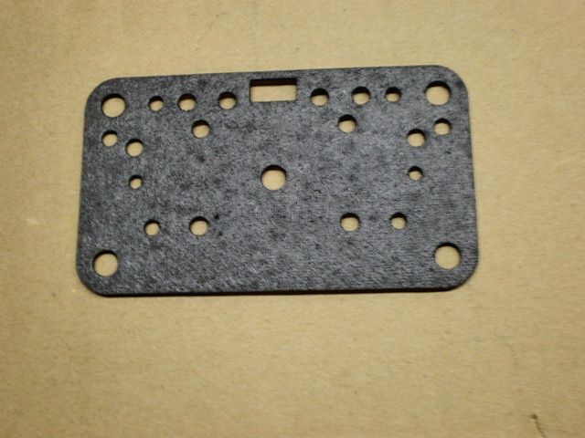

Make sure the metering block gaskets are correct. I just ran into this problem after someone else rebuilt some carbs.
It had this gasket installed and it was filling the motor with gas.

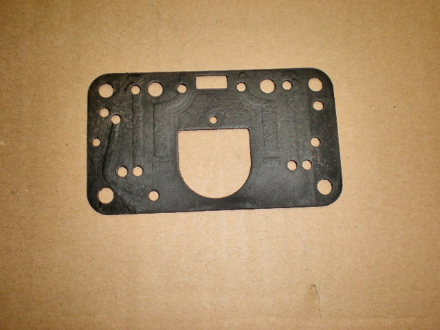

It needed this gasket.
I damn near pulled my hair out trying to figure out why it was so rich.
They actually used to make another gasket yet.It is almost exactly the same gasket as lower pic.Just has the small hole above power valve cutout deleated.This was usually found on the mechanical sixpack.

Both the above are four barrel gaskets,incorrect for a 6pk.These are the only correct 6pk gaskets,top,center carb,bottom,ends carbs.If you have raw fuel in the engine it can only come from a bad needle/seat or O ring or high float level,or high fuel pressure,nothing else.
