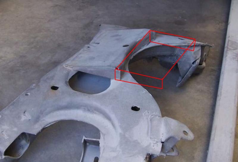

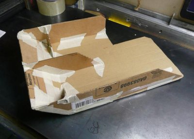

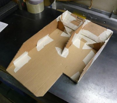

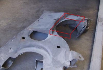

I have a 7+ Qt oil pan, It hangs down pretty low. I am worried about hitting something and draining out my oil. (BAD!)
I have been checking out skid plates, is there a problem extending the existing skid plate to cover part of the pan?
My cardboard prototype below. (has access cutout for draining oil.
Looking for feedback on the extension past the K member. Thanks

I was just wondering if there are any negatives I am overlooking by covering part of the bottom of the oil pan. Thanks
Service station lackeys won't be able to lift the car by putting the jack under the oil pan anymore
tallhair has a good point...YOU will have to build a "fixture" (easy enough) for your jack.
So, I would not build to cover...in this case.
I would build to shield ...
Another words, build a "dam" style set-up...
But anyway..good luck
definetly do it, i had a deep sump 7qt pan on and i hit a speedbump and cracked it open, no damage but i put the new 7qt road race pan on fro milodon, same capacity but it sits up higher than the k member
Just switch to the 6 qt Hemi pan like I did problem solved. Fits flush with the k member
Speed bump and shop floor lifts plus a few other things still have a clearance problem with a 6 qt. pan.
