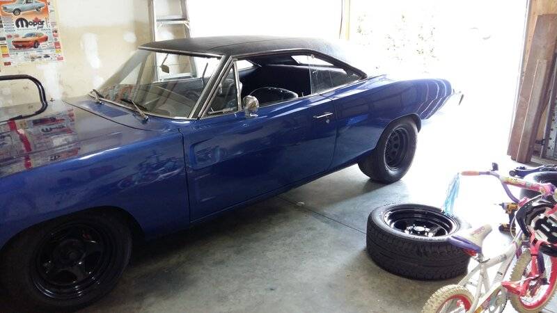

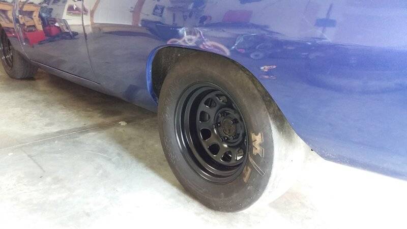

Goy my slicks mounted on the rims . And a test fit just for fun! Can't wait till Ontario opens up the track .

Lol . My bad totally forgot to post the pictures hahaha
68 Charger R/T full street trim .
Slicks are a used set of ET streets I picked up . 26x10x15 .
Personal best is 13.22 @ 105 with 60ft 1.9 on BFG g-force street tires .
Hoping the slicks will get me to the 12s

Finally made it to the track.
First run I put the tires at 15 PSI, which was way to much was spinning a lot off the start. I got down to 11 PSI and the car started to hook.
I ran a 13.19 then hot lapped back around and hit my new personal best so far
13.03 @ 104.64 MPH with a 1.87 60 ft time
I would of liked to make one more run but I had leave .
So very close to the 12 I was looking for, and there is no doubt the car will do it, just another day.
Another thing worth mentioning , I was running the car with out the check-ball in the vacuum canister, last time I was out. I had put the ball back in to see if it would effect the street manners at all. I kind of forgot about it when I was at the track, and my first few runs my MPH was way down 101 range . When I remembered about the ball, I decided to leave the ball but went to a lighter spring in the secondaries. I pick up .8 of MPH in the 1/8 and back up to my high 104- 105 range. I will probably try a lighter spring still next time (currently running tall Yellow) , and I know I can still get more off line.
