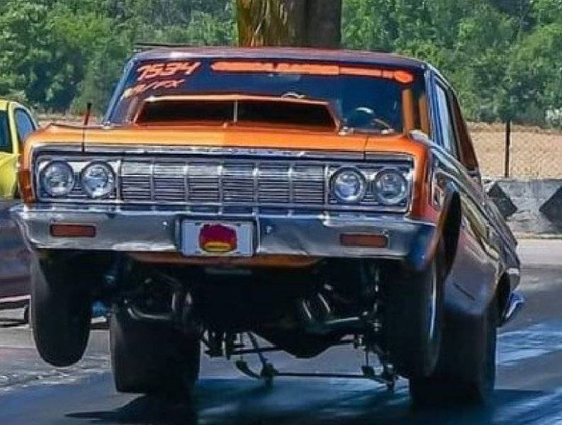

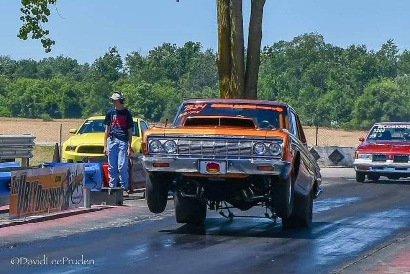

We ran Ubly Dragway this weekend. Old school track 1/8 mile. Track prep was very good. Air was finally decent as well. The car hooked so hard on the first pass it shook the tires, bad. We addressed that by tightening the rear shock rebound 6 clicks. Went from 14psi to 12psi in the slicks. The result was in the attached picture. Throughout our event we were able to make test runs anytime. So we continued with front shock adjustments. Also put smaller pump cams and squirters in the carbs. The results were excellent. Car caried the front further every time. My theory was it held the pump shot for a longer period of time. With less initial fuel at the hit. I struggled at the tree. This tree is slower than average for sure. The last pass I bumped in deeper. I'm sure it would've been another 5.64 run. This was the first weekend for a pair of merge collectors that were laying around as well. The car carried the front in the picture should to just before the 60 ft clocks. Then settled down smooth. Going to try and test at Milan before Dragway 42 in two weeks.

I would buy a copy of this photo, frame it, and hang it in the shop! What do you say Doug?
Mike
Great news Doug! :thumbsup:
Im keepin that pic and adding it to my Mopar archives :)
Edited the pic a bit...
dvw, looks as though you got handling your Plymouth down to a science. You should start an instruction class for some guys who own hellcats – who can’t avoid smashing them up, lol
That is a lot of air. I presume that's on a brake. Any NO2 at that point?
If the tree is not dead on the specs, that’s gonna throw you off for sure. Super glad to see the new bullet is performing! Great photo by the way!

I actually like the unedited picture better. The two, blah, more modern cars really put in perspective how special this old car is. Bet neither of them carry the front tires like this Plymouth.
