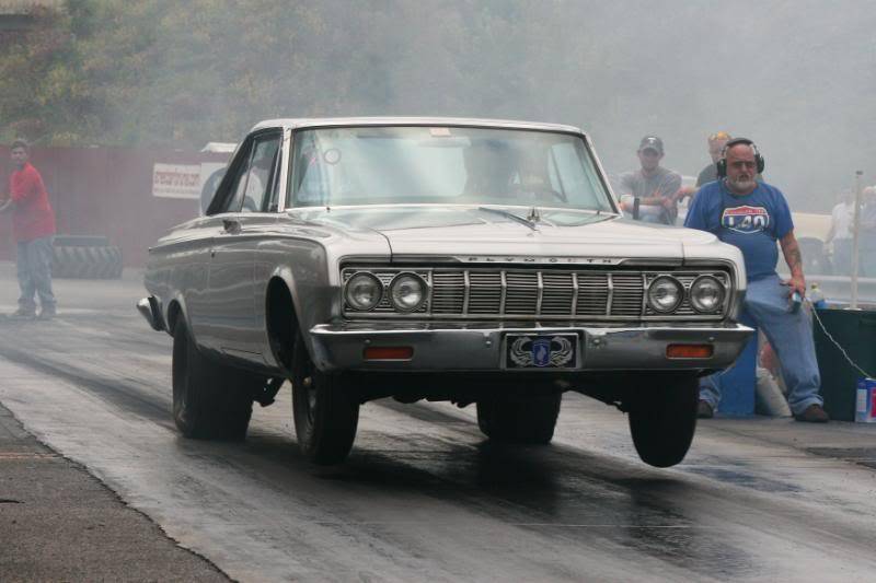

Have a question for you racers with more experience than I have....
I've been running 28 X 10.5 X 15 MT ET Drags but have upgraded carburetor and am now overpowering the slicks both off the line and hitting second gear...even with good burnout and 85 degree air temp.
I'd like to upgrade to a 30 X 9 X15 Hoosier Radial drag or a 30 X 10.5 X 15 Hoosier radial drag.....
Any of you using Hoosier's drag radials ? My set-up is a 3700 lb automatic car running 11.70 at 116 mph....
Thanks

A radial tire isn't going to help you.A radial slick usually helps with high speed stability.From the sounds of things you have shock and alignment adjusting to do.Need more details on your setup!
Not expecting that the radial versus bias is going to help that much...although a little more high speed stability wouldn't hurt...
I am hoping that going from a 28 inch tire to a 30 inch tire will help get more of the increased torque from the carb upgrade to the ground...
Car has 90/10 front shocks, 50/50 rears, launches hard and straight, but I'm
getting more wheel spin now and my 60 ft times have gone down from 1.62 to 1.72,,,back half of the 1/4 is .06 quicker now..
Splicer
The taller tire will give a little larger footprint wich in theory should help with the launch.As for you traction problem when hitting second gear could be shocks.You may need to tighten up the rebound.
If you're having problems with traction the radials are the wrong direction. Radials are very temperamental on marginal tracks. (Speaking from experience). Now with that being said on a good track the radials are a good .10-.15 quicker than bias because of the low rolling resistance. The second problem with the radials is they are good for only 30 passes, after that they go away quick.
How many passes do you have on your tires? A carb change should have made that big of a difference in HP that it would affect your traction that much. There are guys running 8.50's and 1.20 60's with 10.5" tires. I would bet that your tires are going away or something is binding in your suspension.
What kind of suspension are you using, S/S springs, Cal Tracs, or Ladder Bars?
Do you have room for 28x14.40/15s? You'll also loose some "gear" going up to a 30" tires
Current tires have 33 passes on them,,,,,, rears suspension is super stock springs....
Carb change was from an 870 vacuum carb to a 950 DP...made a huge difference...this is on a 505 stroker with 600 ft/lb torque at 3000...
I noticed the traction issue going from 1st to 2nd when I dropped my shift rpm from 5600 to 5200.........
Car is not tubbed(64 Polara) so I don't have room to go any wider..

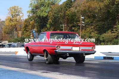

It's not been my experience that they are finicky, nor have a short lifespan. I ran nothing but Hoosier 30x9 radial slicks on my 3424lb Fury for years. I would get around 80-90 passes on them, and they hooked no matter what night I went to the track, and no matter what track I went to. BTW, my combo was a stock stroke 440, 4.30 gear, foot brake leaving at 2900rpm, shifting at 5600rpm, super stock springs, Rancho 9 way rear shocks. Consistent 1.43 60', 6.74@102mph 1/8 mile times (which equates to somewhere in the mid 10's 1/4 mile).
