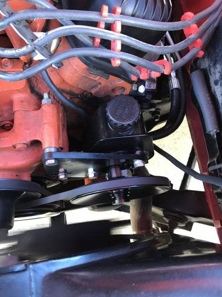

Hi All, when I bought my car, one of the main issues was severe wondering in the steering. I adjusted WhT I could but it’s just wore out. I have been shopping for steering boxes . Redhead has always been my go to, but I’m kinda drawn to the Borgeson unit. Has anyone else used one of these units ? It is 2/3 size to accommodate headers, and has a true 14/1 ratio. All pluses in my book. Any feedback?
Installed 2 Borgeson units one on a 69 Chevelle and one on a 69GTX both times the owner was very happy and said it drove like a new car.
