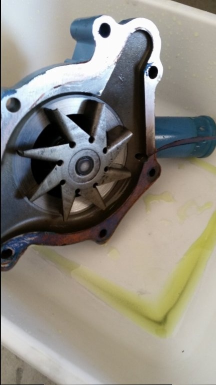

I am tired of screwing with water pumps and water pump problems on my 340. When the motor was built, I had a 8 blade mopar performance pump, but it was in the standard housing, so I changed it to the proper mopar performance 8 blade with the correct housing, only to have it start leaking at the weep hole a few hundred miles down the road. I sent it to be rebuilt and the tolerances made better, it was out of warranty from mopar, (90 day bs warranty), however, now this one squeals, and I notice at higher rpm, the pulley has a wobble, so thinking this is the cause of my mystery engine vibration at 3200 rpm. Good the guy guarantees his work for life of the car, so I can send it back to be looked at, but now I am not sure I even with trust the damn thing.

Well, found out what happened to my pump, looks like the bearing shifted forward and the impeller was rubbing on the housing. The guy that rebuilt it is already sending out another pump with pickup for this one at no cost to me. Nice to see such good customer service. I just now have to figure out the best way to flush out my cooling system.
