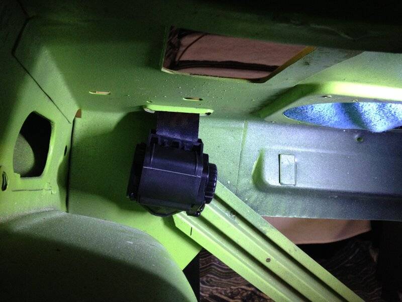

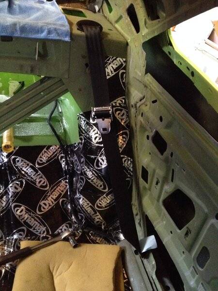

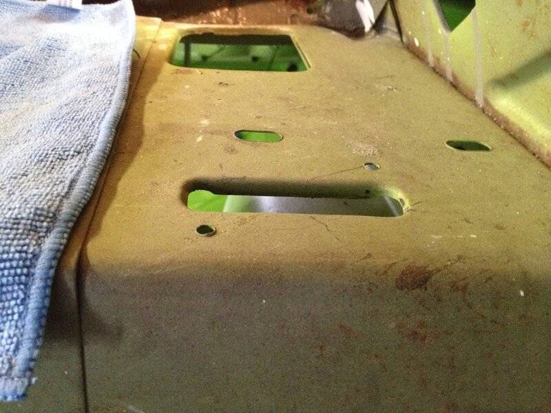

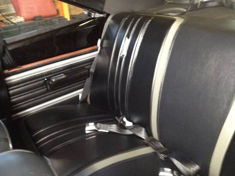

For people to ride more safely in the back seat, I added 3 point seat belts. These used factory shoulder belt holes in my 1970 Road Runner package tray. They work great and in my opinion, look like they might have come from the factory:

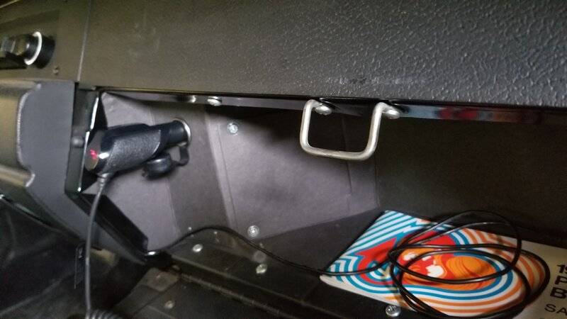

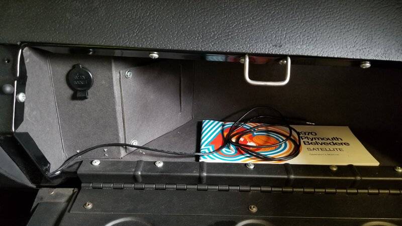

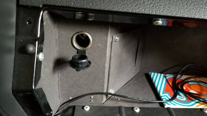

We have tons of devices nowadays that need charging or power. Things like phones, Garmin navigation, etc. So I figured I would add an extra power port inside my glove box so I could charge a phone and have it be out of the way. A cord can also easily pass through the bottom side of the door even when closed to power a Garmin navigation unit.
This works great in some cases, but in many cases the plug that fits into to power port is too big so I can't close the glove compartment door! I should have placed this at the very back of the glove compartment, but in my case I had other stuff jammed back there that made this modification not possible.

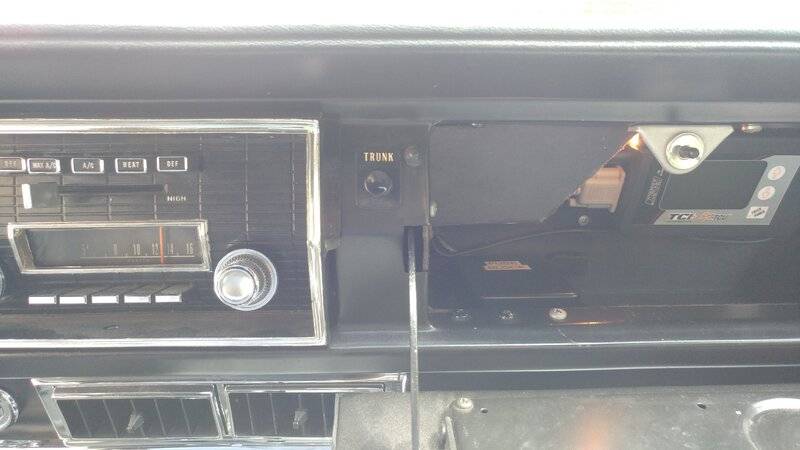

Here's a small mod that worked on my 67 Coronet. I added a power trunk lock, but where to put the button? I found an OEM switch and it just fits behind my glove box door without interfering with the hinge mechanism. It's within easy reach of drivers seat and it can be locked behind the glovebox door.
Great thread idea.
Like the shoulder belts.

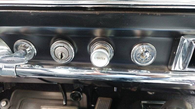

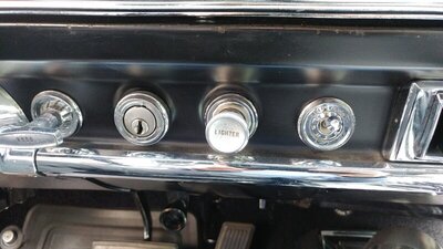

When I installed a Charger grill assy into my 67 Coronet, everything was pretty much a bolt on except where to put the "headlamp not locked" warning lamp located in the Charger gauge cluster?
What I found that worked was to take a brake warning lamp housing and modify the Charger plastic lense to fit inside it.

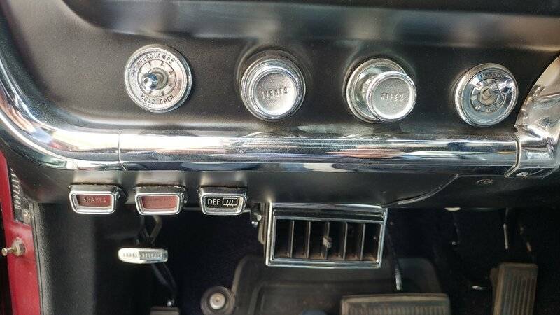

I liked it enough to do the same again when I added the rear defroster.
The switch for the defroster used a "rear window" bezel from a station wagon.

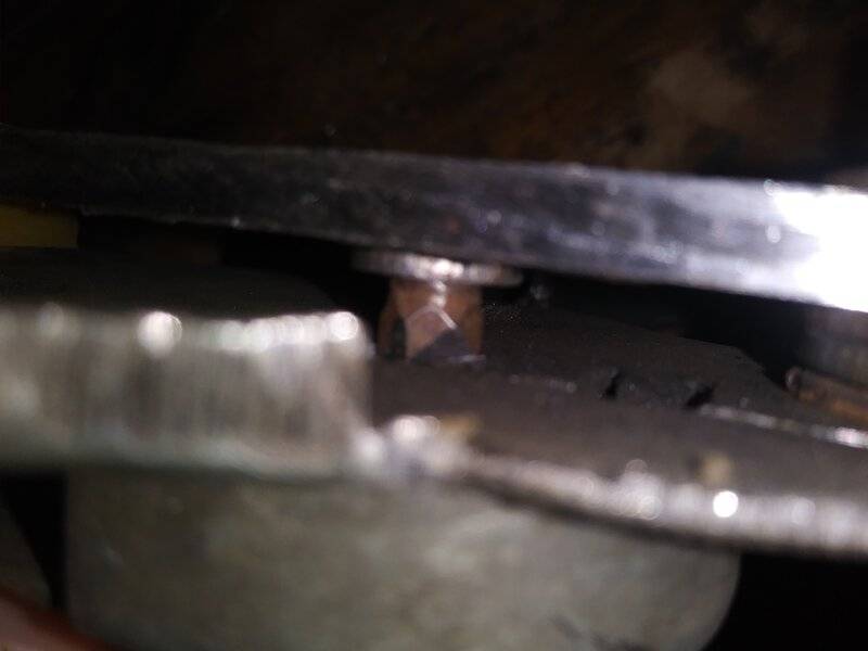

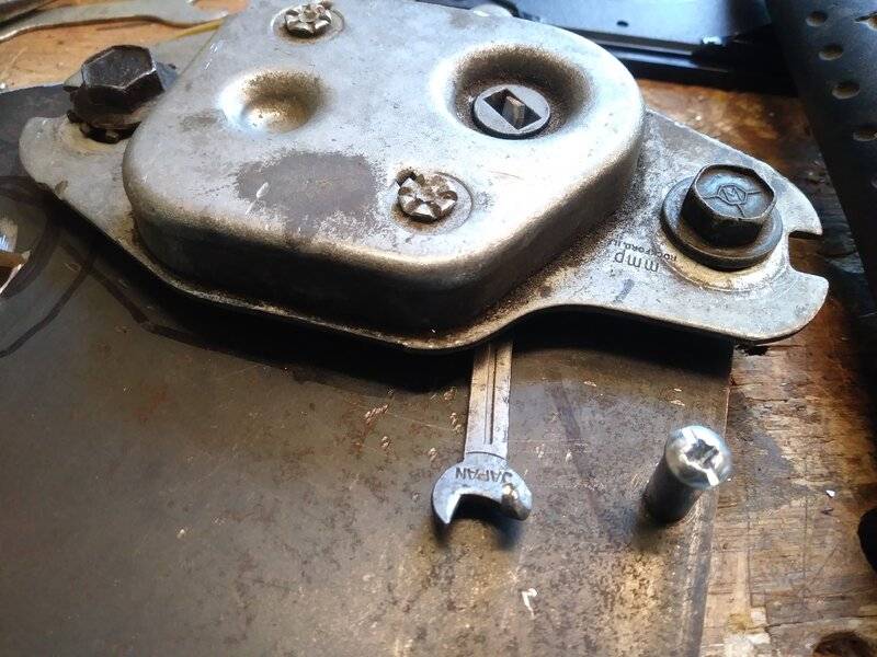

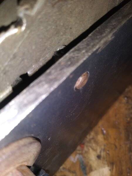

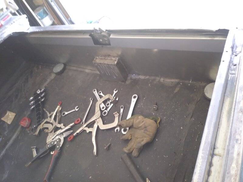

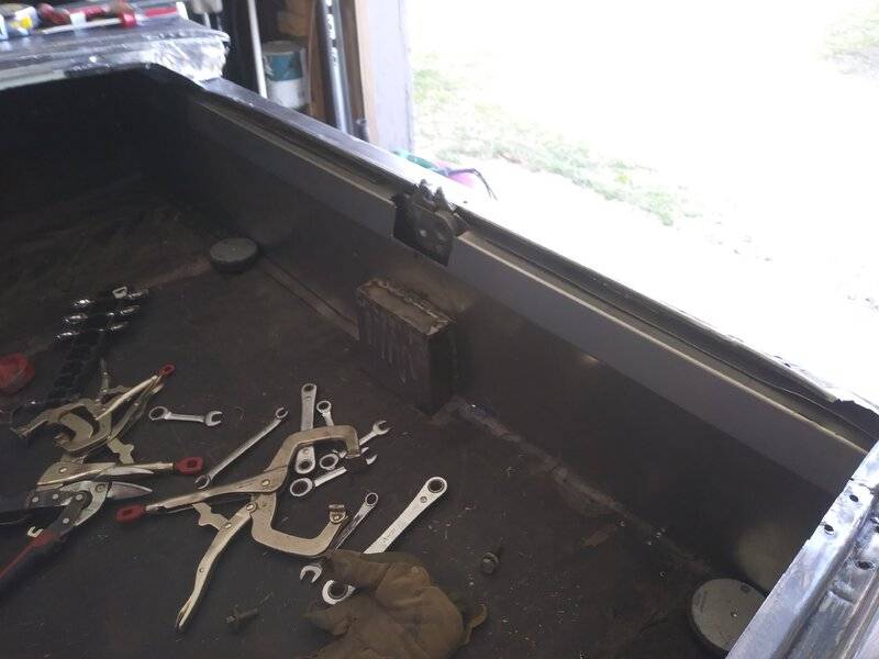

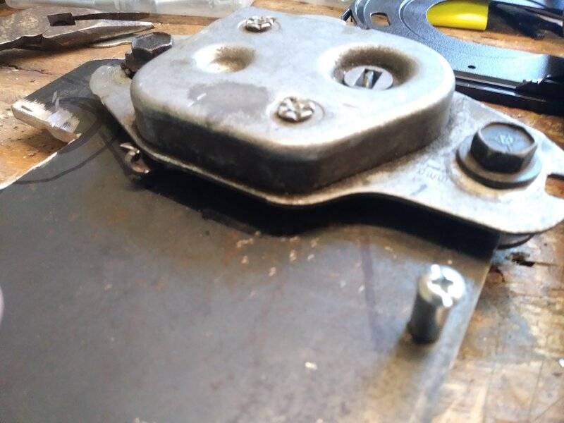

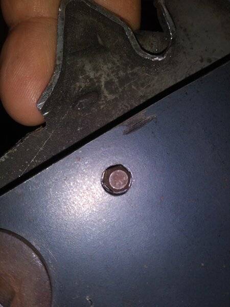

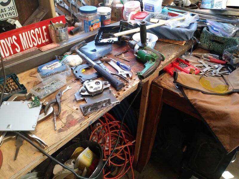

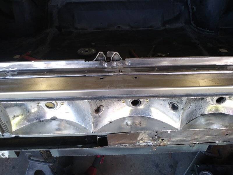

This also worked out after several false starts. Setting up the trunk latch release lever. Because I reimagined the entire rear face of the Coronet, the trunk latch was left sitting 8" too low and so was placed on a carefully angled plate that bolts to the original place. This brought the latch up to the right height/position to engage the trunk catch bar. After thinking about it for awhile I tried several times with different ideas to create a latch release that wouldn't get in the way of the 66 T Bird light panel that runs to the inside rear of the plate with very little room to spare or interfering with the close out panel that runs across the front of the plate. So it had to be out of the way within the 'sandwiched area' between plate & latch body, about 1/4" to 3/8" space.
It also had to be maintenance free and pretty much indestructible because I'm not taking this apart once it's all installed and done.

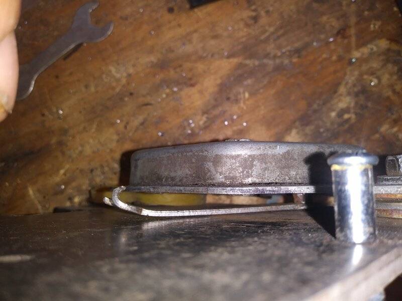

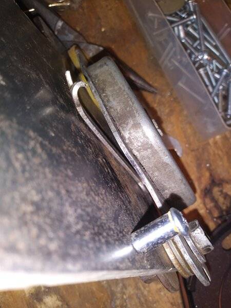

So I finally chose the right item to sacrifice for the lever axle. It's an adapter for the insert driver that has an Allen end and a 1/4" drive end. I found a tiny closed-open end wrench sitting in a drawer that just happened to fit the Allen end nice and snug. So that's the lever worked out. Then I needed to create a 'flat tip' on the 1/4" drive end that would fit snugly in the latch release slot on the back/inside side of the latch mechanism. So, vise grips and a grinder and wah-lah, done. Now it had to be the right length to leave the wrench not jammed up against the plate and scrapping as it swings. Done. Now I needed a pivot point for the other free end of the 'axle'. Drilled a hole in the correct spot of the plate and once the latch and the plate are married up with the axle end poked into that hole, it needed the right number and thicknesses of washers at each bolt to space it out right, so everything worked. I'll be cutting the open end wrench off and drilling a small hole in the stump for a return spring and for the cable pull to attach to. Added a bolt with an aluminum roller for the cable to ride around when pulled, and called it done except for final clean up and paint. Included a picture of the " MAd Scientist" workbench...lol.
As you can see, I keep a 13oz Esswing framing hammer lying around just in case brute strength is called for...
The latch in position.....

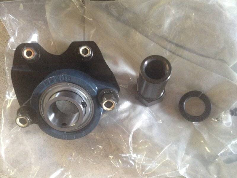

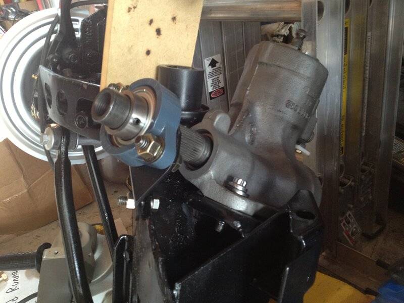

I added a sector support kit. What the heck is that, you ask? Well, it is essentially a bearing that supports the bottom of the steering shaft, below the Pittman arm. With the forces generated when more aggressively driving through a turn, there is normally a lot of flex in this steering shaft. A sector support kit stops this flex.
This is a sector support kit:
It bolts to the K-member. Here is a picture mocked up on my steering box (without the Pittman arm installed):
This is a small detail that goes sight unseen, but helps very time I take a corner!

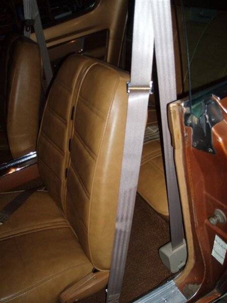

Converted my cuda to modern retractable belts. Now I just have to figure out if there is any way to do that mod in a 66 Charger.
Sure there is. XV racing sells a kit with single retractors and a drop down section to help belt fitment over the shoulder.
The picture below was with a set of 3 point belts from Snayk Oyl and while they worked fine, they needed a drop down segment from the overhead mount to properly fit across the shoulder.
Are you saying that the 1966 model had no type of overhead mount? If so, one can be easily retofitted if the headliner is out. A simple section of 12 gauge sheet metal welded to the door header would work, one with a nut welded to the back side.
Yes the overhead mount is the issue. Interior is clean and complete, so not sure I want to mess with the one piece headliner.

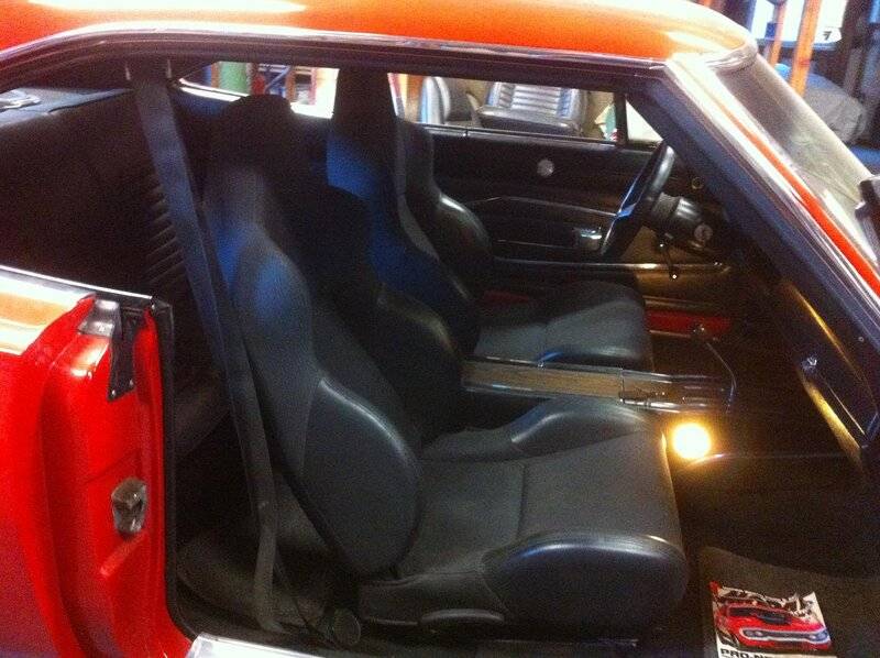

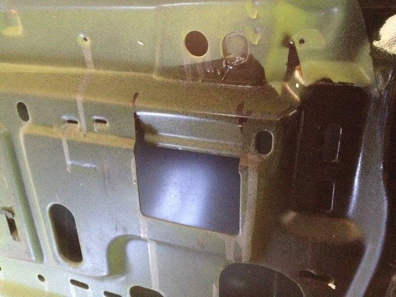

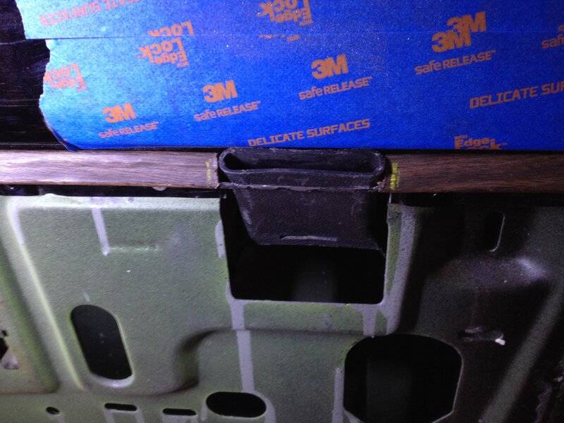

OK, so speaking of front seat belts: On the rear I showed you what I did. For the rear, since I have a coupe and not a hardtop, I have space under the rear windows since they are fixed and only pop out. So I mounted the retractor inside the door panel and passed the belt out at the seam at the top of the rear "door card" (not sure what the heck to call it back there!).

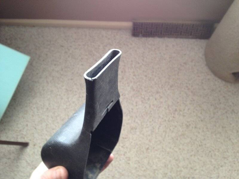

I took a seat belt plastic piece from a 73 seat belt retractor:
Then I modified the metal under the rear window:
Then I stuck the retractor for the 3 point belts through the modified plastic piece so it exited right at the top of the door card:
The end result looks like this. Not perfect, and perhaps I could do a bit more metal work, but still hides the big retractor. This is the best picture I could find, but on the left side of the picture you can see the front belt exiting the door card right through the molding (by the way, my Road Runner was purchased with this fake wood applique on the molding. In a nod of respect to it's heritage, I reproduced it. I know it is not original...).
Hawk
