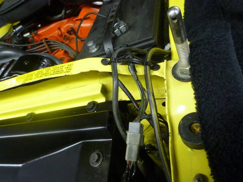

That looks like the Superbird vacuum line/headlight harness clip on the rad support.

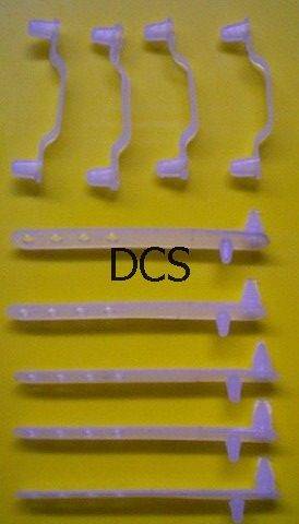

The particular strap as linked is an E-Body and 71-74 B-Body piece. The 65 to 73 C-Body uses a similar strap, but the dimensions are different. As Wayne noted, it was also used on the 70 Super Bird for the headlight vacuum hose routing.
I have attached a picture of the 66 to 70 B-Body kit that we provide to many of the vendors. The style with the two push in nipples was used to keep the battery cable in place in the recessed area on the inner fender. The single nipple strap was used on the passenger side to keep the washer hose and other wiring in place.
