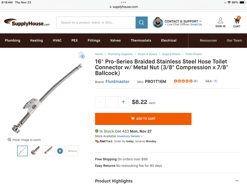

With well over 30 years in the business, I've saw the amount of damage that can occur from water leaks. Those plastic ice maker supply lines are a common source of leaks. I use stainless braided supply lines on all fixtures, icemakers, dishwashers and washing machines.

I always shut off my water and gas when I leave home for a trip. I have all stainless braided lines everywhere, except the factory plastic tubing on the back of my fridge. I’ve installed a few of those water shut down valves, and so far no problems. I also installed these metal nut toilet supply lines in my home. I was just leaving when the big plastic nut split and began flooding. My truck is stocked only with these lines.
