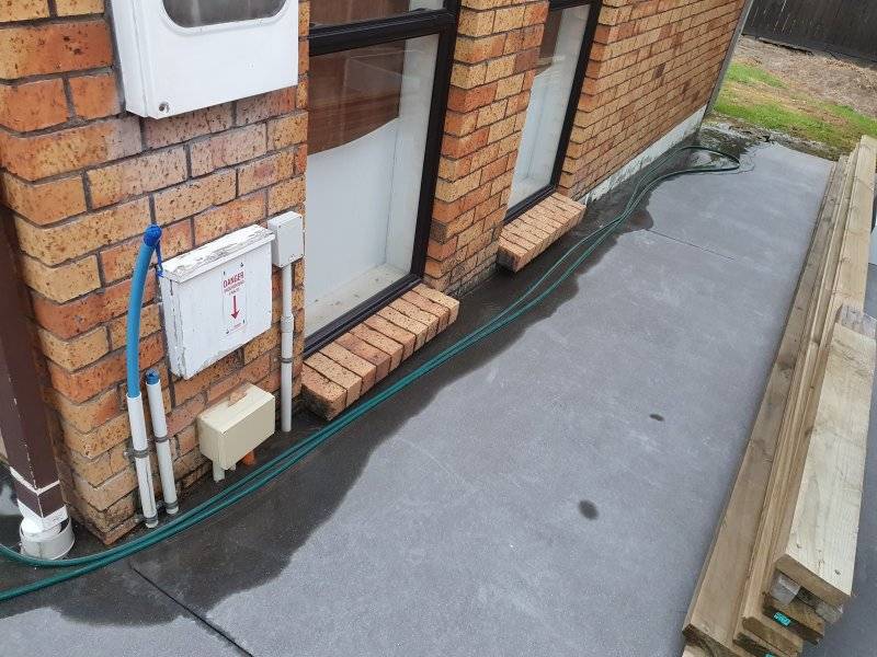

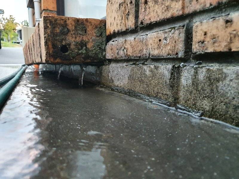

Windows.
Watch the video!!
Thanks..... they are the two side windows in my garage. That concrete was lawn up until about 4 years ago.....I have the windows mostly covered over inside with shelving. Keeps prying eyes out from seeing my stash. :)
