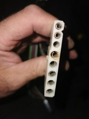

This is the connector for the wiring harness that goes to the ignition. It ties in to the other connector at the base of the steering column. As you can see, it got hot and melted the plastic. Now I'm not sure if that's where the smoke is coming from, so I'm digging the steering column apart. I did remove the signal switch wires and tested them. All good, no issues. I replaced the signal wire harness and switch assembly a couple years ago. I pulled all the fuses to start with, and all are fine, and the proper size as per the cars wiring manual. Regarding the smell, there wasn't any that my wife or I could detect. She has an acute sense of smell, and still couldn't smell anything. Still digging. I'm getting way past my comfort zone here, lol.
First determine what that connector feeds - work from there
Right now, from what I've found, there were two wires with issues. One is battery feed J1-12R, which is the one that is burnt in the picture, and next to it in the 8 wire connector, is E2B-18O, which was actually not connected as the male and female had come completely apart. J1-12R, had also come apart but not all the way. Considering the burn and melted plastic, and the fact that the smoke would puff a bit, then not at all for a while, then again, I figure the battery feed wire was heating up because it wasn't making a solid connection at all times, which created resistance and a possible arc. I've cut those two wires from the connector, and will connect them separately, and then heat shrink them. In another hour or two I should have my answer.
I have seen worst melts on that plug and still no smoke... If you are saying the smoke comes from inside the colum, that plug is outside.
Yes they use to come loose with time creating resistance, hence heating and melting/burning the plug

some example of worst conditions ignition switch plugs
https://www.forbbodiesonly.com/moparforum/threads/ignition-1-“run”-shorted.166345/
the most tipical terminals able to melt down the plugs are red which input from "batt" source" and black acc output to fuse box. Quite often also the blue one ( RUN circuit ).
New Molex standard terminals are avaliable, not the plastic plugs thought ( the female new when getting a new ign switch ).

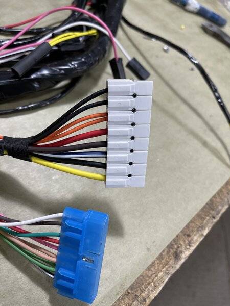

an aftermarket and nice solution find by a member here ( 72RoadRunnerGTX ) is the Anderson powerpoles terminals and plugs which can be stacked on and make them look somehow original if getting them on white.
72RoadRunner post a pic of his car mod for these conectors
The ’70 and up ignition switch Molex connector have been melting down since the very early on. Under-rated for that use, red and black wires typically melt first, highest current loads. As mentioned, have been using Anderson Power poles for that disconnect for some time, current ratings up to 45amps.
