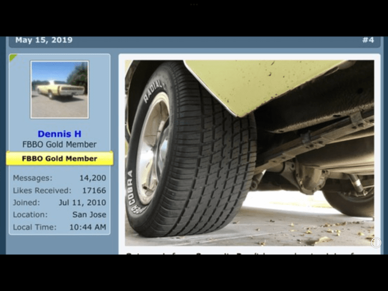

Chrysler put the 8-1/4 behind the 383 2bbl in earlier year cars, so I would not be surprised if the 8-1/4 in your car is original equipment assuming it is a car coded for 2bbl 400. A 4bbl car would have originally had an 8-3/4 axle.
The good news is that you should be able to spin a tire with a good tune and a little power braking. I think your goal of doing burnouts is easily obtainable without investing in axle upgrades, though it is 10x more fun when you spin both tires.

I gotta say, that's pretty much the goal. The elusive 2 wheel peel. I guess I've been looking for a 8 3/4 because everyone says they are easier for gear changes and more sturdy. Would it be worth just upgrading my current rear end? If so, what would I want to start with to beef it up?
Your description of the current idle problem and the fact that you cannot spin a single tire suggests that tuning and/or repair is necessary before anything else. First step - tune/repair and get one wheel to spin.
Next step, after you get some power on hand, any axle upgrade should involve an 8-3/4 (for the reasons people have stated).

Your car is a 73 B body.
Starting in 73, the spring spacing is different then earlier.
However, Chrysler maintained that spacing until 1979.
This means an axle from a 79 Cordoba will fit under your car. It also means instead of looking for a 1 year only(maybe 2, some might be found on 74's) 8.75" rear axle, you can look for a 9.25" rear from basically any 2 or 4 door b body until the end of the decade.
Hint: police cars came with a 9.25" sure grip 3.23" rear.
But really any that fit, in any gear ratio works. Why? Because the 9.25 has gears everywhere. Even using something as new as a set from a 90's truck, you can drop it in if you look up how to modify the c clips to fit your axles.
But honestly, if you keep an eye out for 70's 9.25's out of a cordoba, or coronet, or (late in the decade) fury or monaco(not earlier, c body till 77 with those) I am sure you can find one pop up. Stronger then the 8.75, (old guys all gasp!) not that you will need to worry about that with a mostly stock 400. If you are dead set on a 8.75 I have one with 3.23 in it that needs a rebuild, you just need to drive to WI to come pick it up :)
