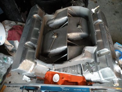

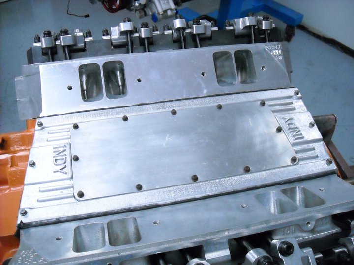

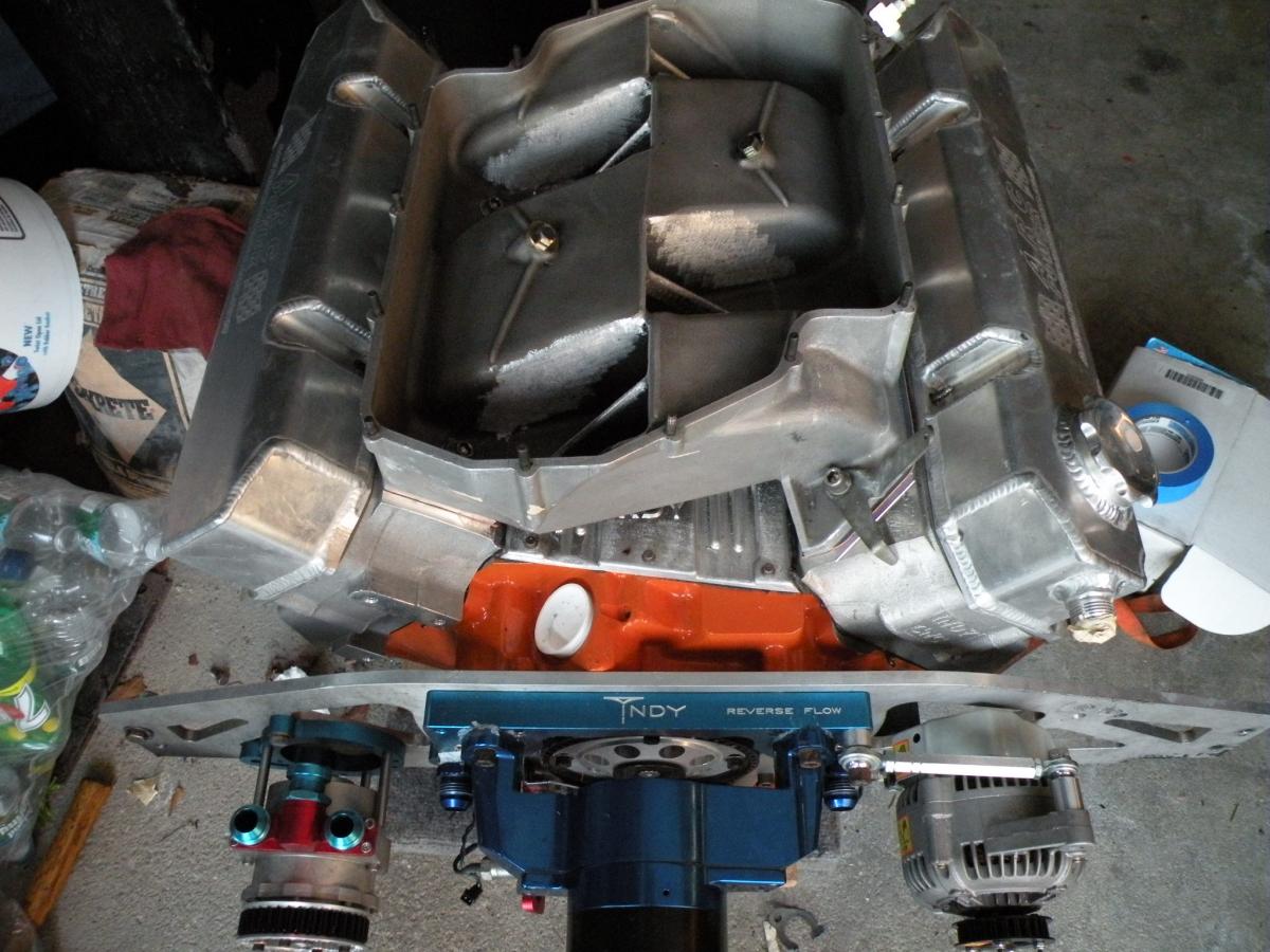

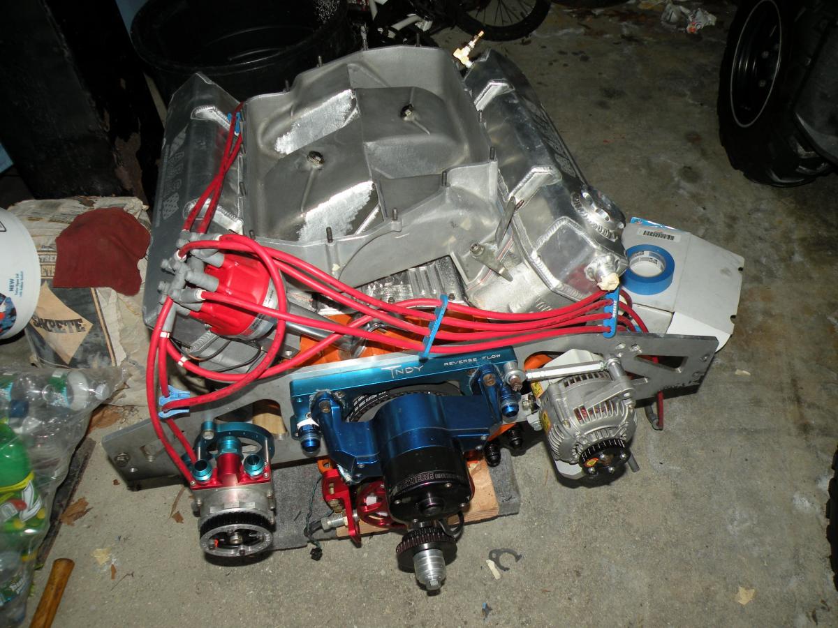

Sneek peek at my 588 Indy motor
one more for now.

Looks sweet man!
When are you making the run to the Motor City to pick it up?
You're going to have a hell of a time trying to decide what car to race this year.

Superstockracer wow that is 1 bad mama jama are you going to dyno it where do you usualy run. You should be in the 8's if the car is set up properly with your name I would assume it is. If I could get in the low 9's with a 479ci B engine in my old RR I would think a 572 with those heads would easly roll in the 8's. Good luck It's a thing of beauty I want one. LOL
Thanks it went 9.22 with old motor 3322 lb. heads flowed 380 cfm @ .800 lift with the old combo. We stepped up the combo and now heads flow 405@.800 lift. Trying a different cam, and putting in a new ATI 8" converter from the old 9.5 PTC.
Low tensile rings put in for vacuum pump. I should be able to get in the high 8's but not sure. .2 with these combos are tough to do.

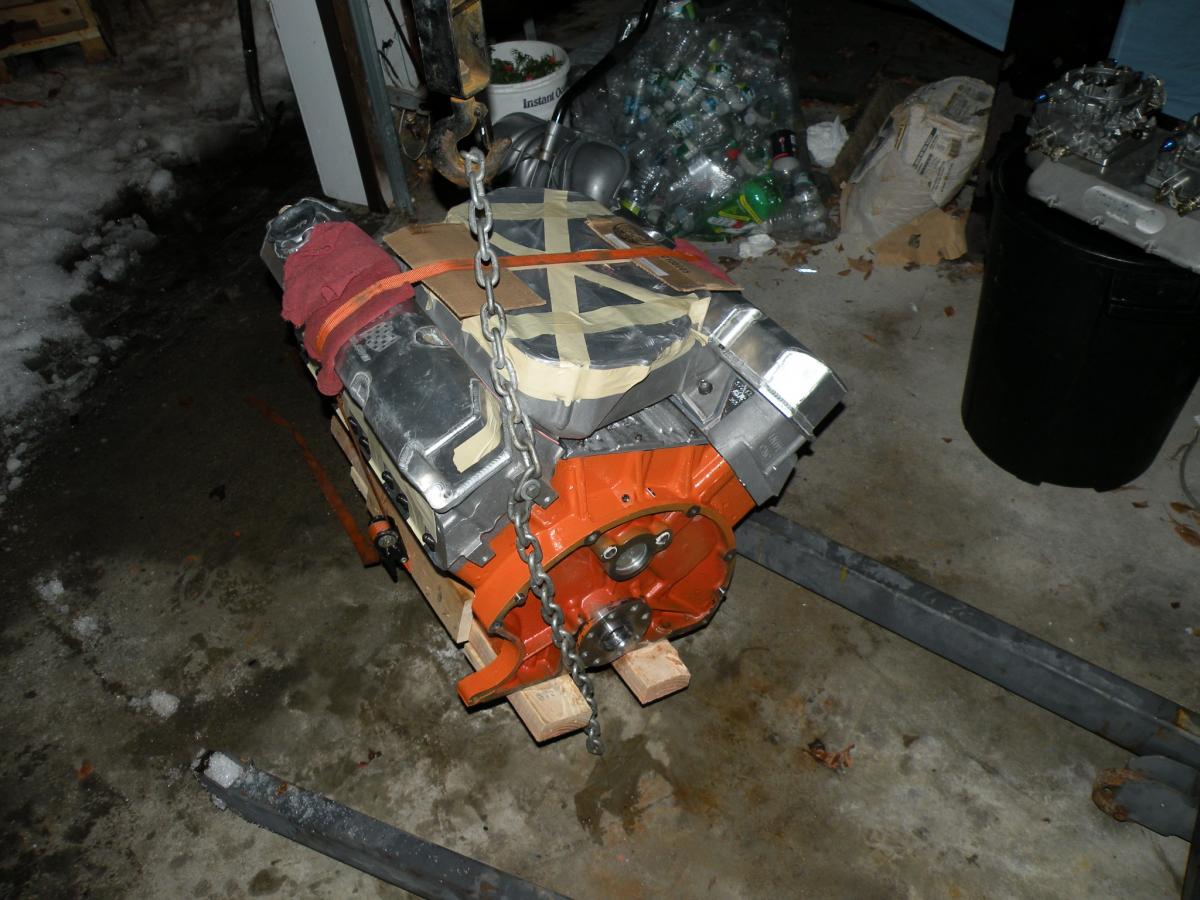

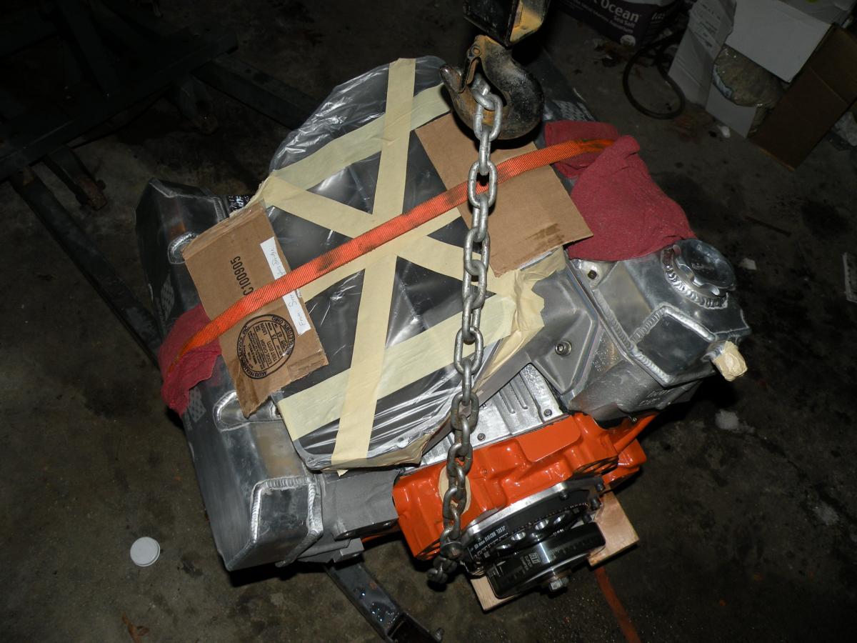

My Indy 588 is back from Best Machine in Michigan and home safe.
Thanks to 440gtx(Clinton) making the trip with me.We made it 9.5 hours each way. Not too bad.
It will be going back in the car by the end of the week.
I can't believe my oil pan is sitting in my dishwasher at home being cleaned.
Tuesday going to take apart the Titan oil pump for inspection and then the fun begins with the installation.Pics to follow.
The motor is in the back of my pickup in a huge crate courtesy of bbody540(Danbury John).

Here's a few pictures of the motor back from Michigan. It's been a long wait.Got alot more done over the weekend but heres a few from a few weeks back. I'm a little behind.l should catch up pretty soon.

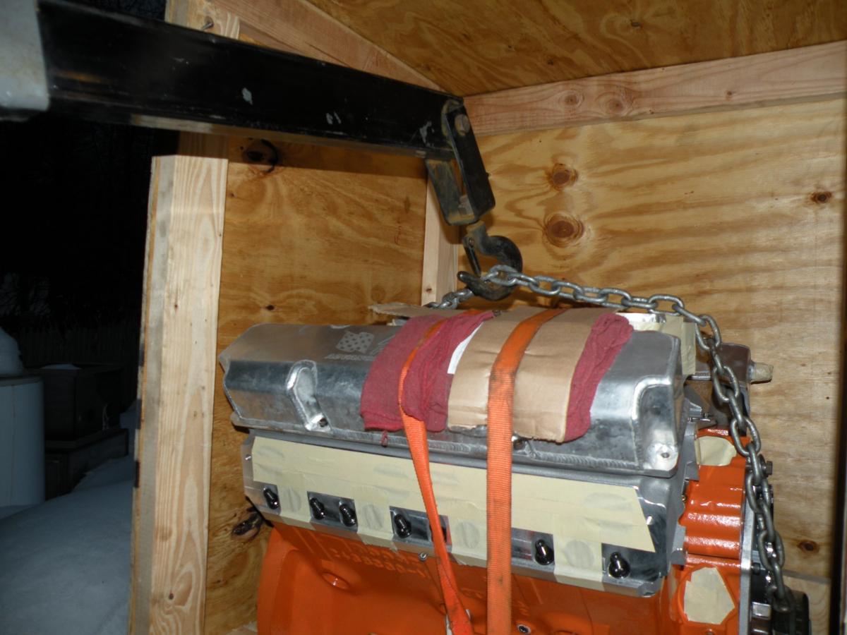

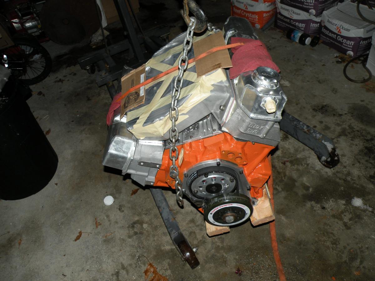

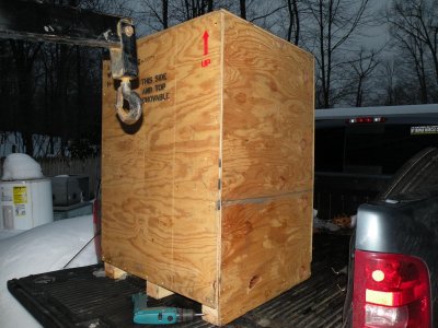

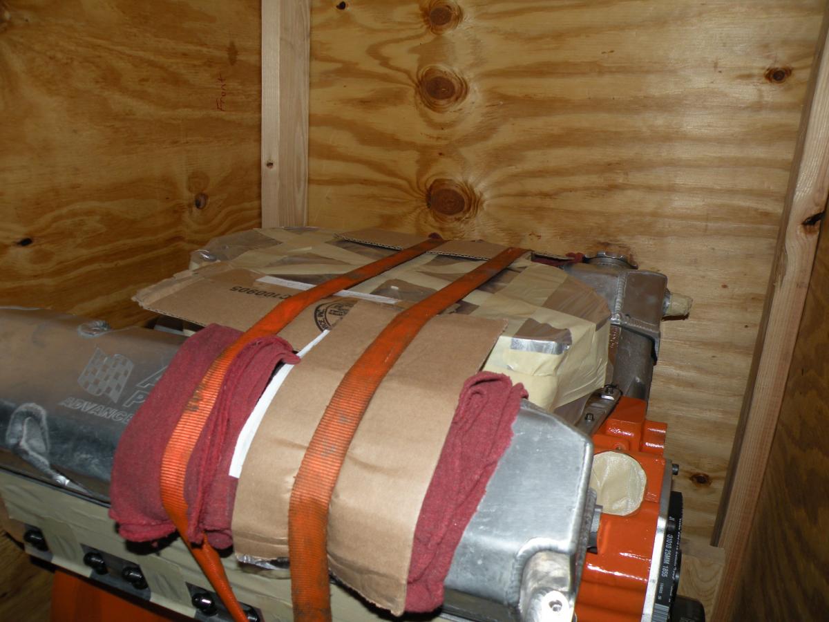

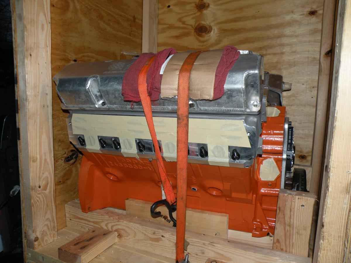

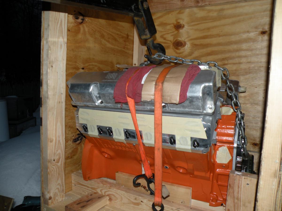

coming out of the crate

That crate gave me a headache LOL chris call me tomorrow!!!!!!!!!!!!!!!!!!!

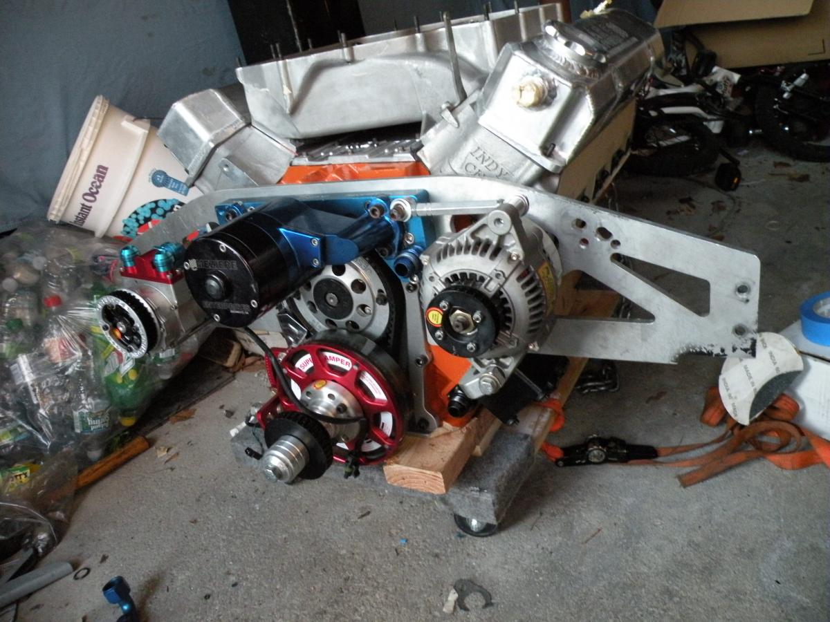

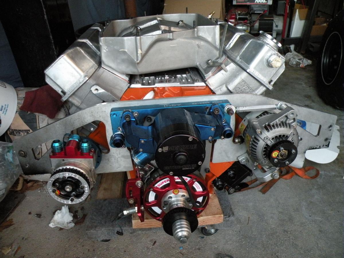

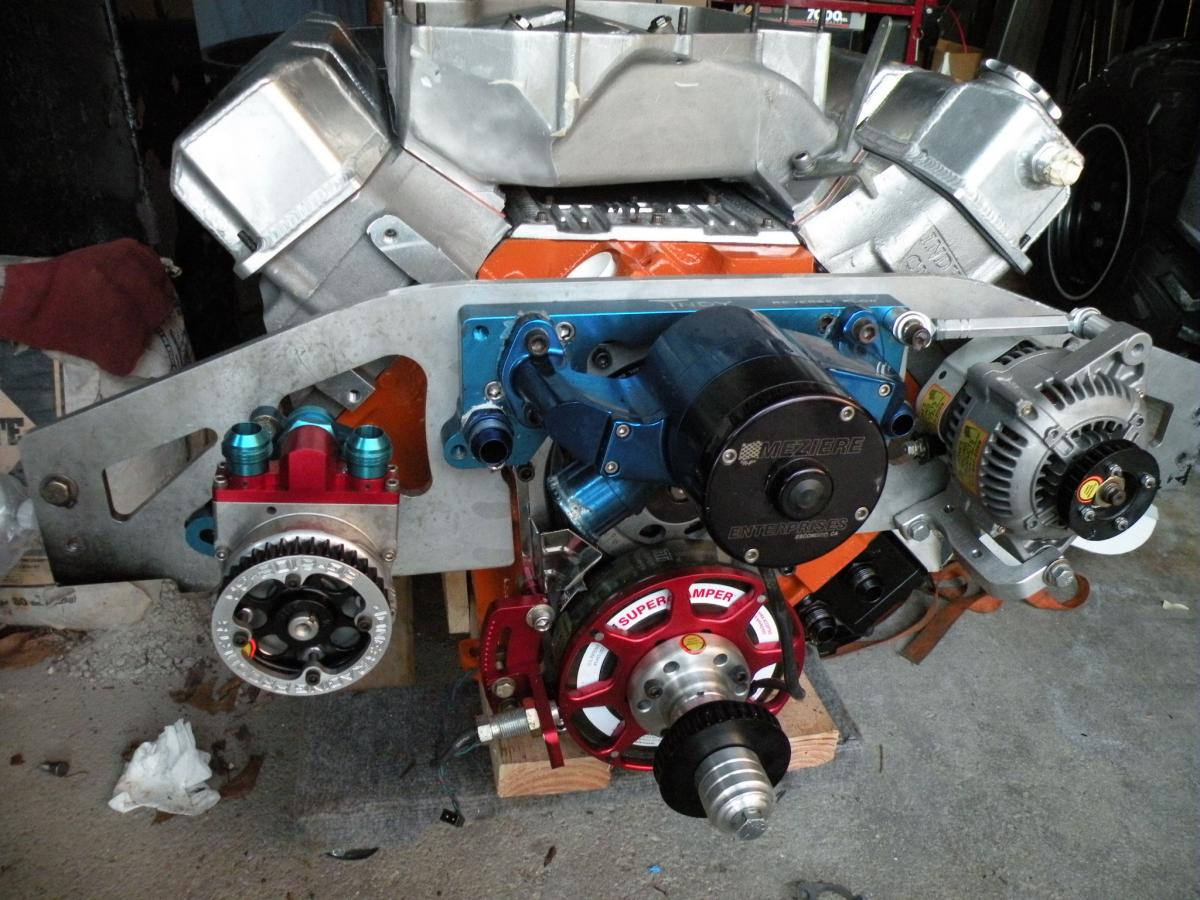

got some more done.
