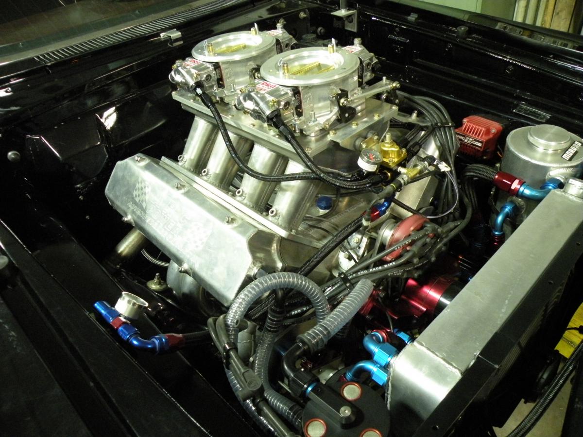

Sneek peek at my 588 Indy motor
Looks great man, you do good work and fast too. I guess you weren't playing around.
No procrastination here!!
2 down, 1 to go, New 582 Hemi going in the 65 Belvedere.
Looks like testing next weekend weather permitting.
Looking for my 1st 8 second pass.
I just uploaded the Video of the startup but its so freakin boring.Dont even think its worth putting on youtube.
The 588 started right up with no glitches.It was effortless. 78 PSI Oil pressure 6 psi fuel pressure and 5 inches of vacuum at idle.

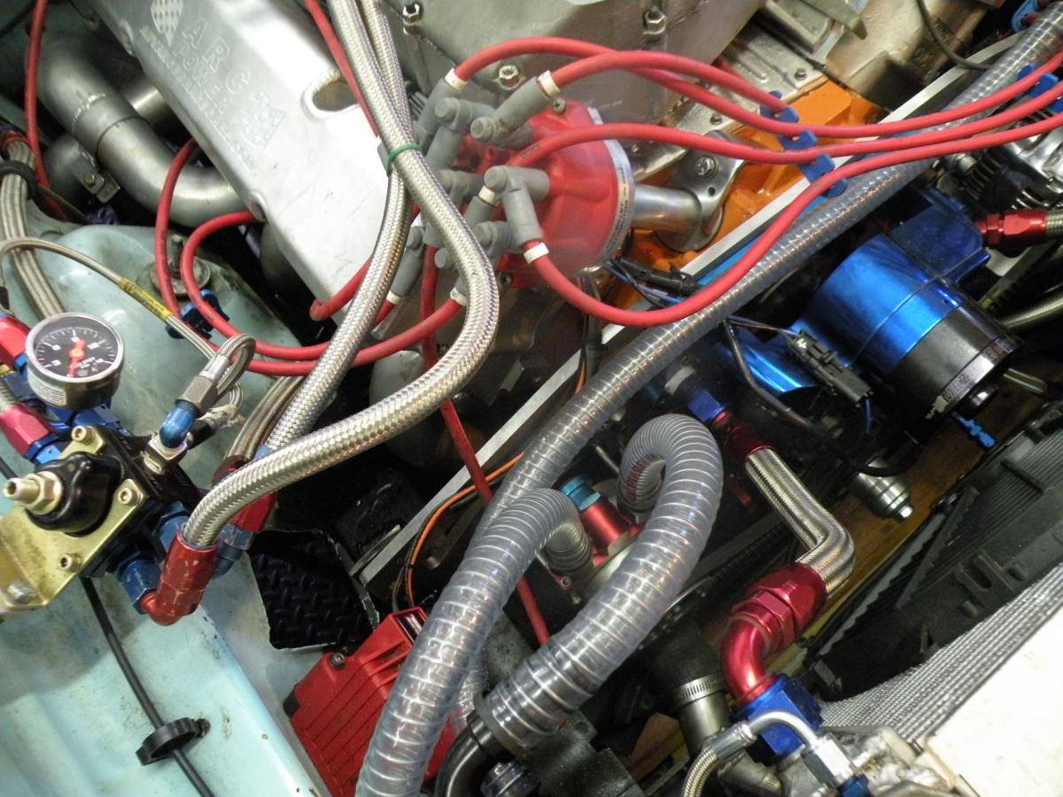

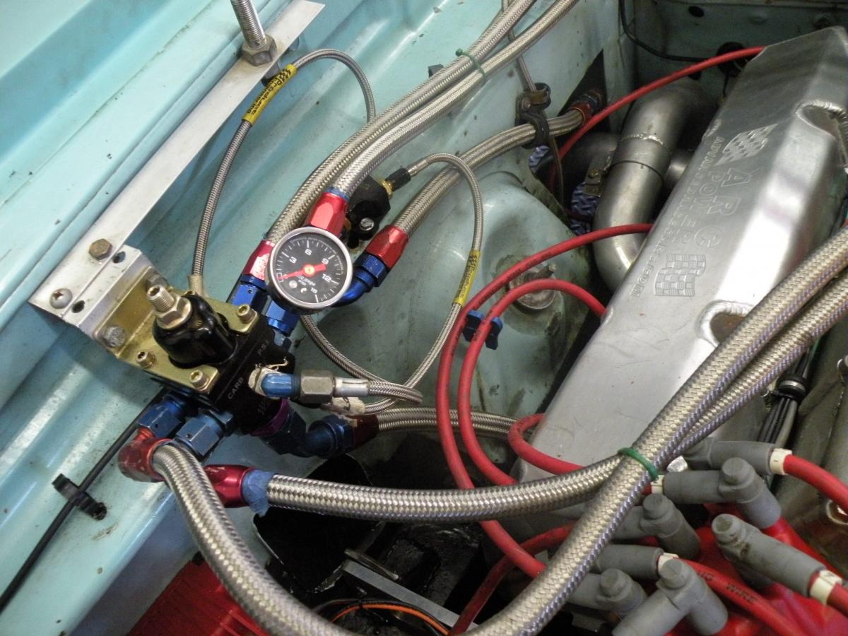

Ok SSR I have a question. What is the other fuel line for on your carbs? I know it is for fuel! I just have never seen 2 lines on that style of carb before. That thing must be one thristy MF.

Those are dual feed carter carbs. I tapped the other side for more fuel. Made it dual inlets because I run out of fuel in the non tapped side of the bowls. With this kind of HP , I found I was sucking the one bowl dry and leaning out one side of the motor.
Now I can run 6 psi and all banks are evenly fed the right amount of fuel.

Never thought of the left bank running low on fuel. That makes total sense.

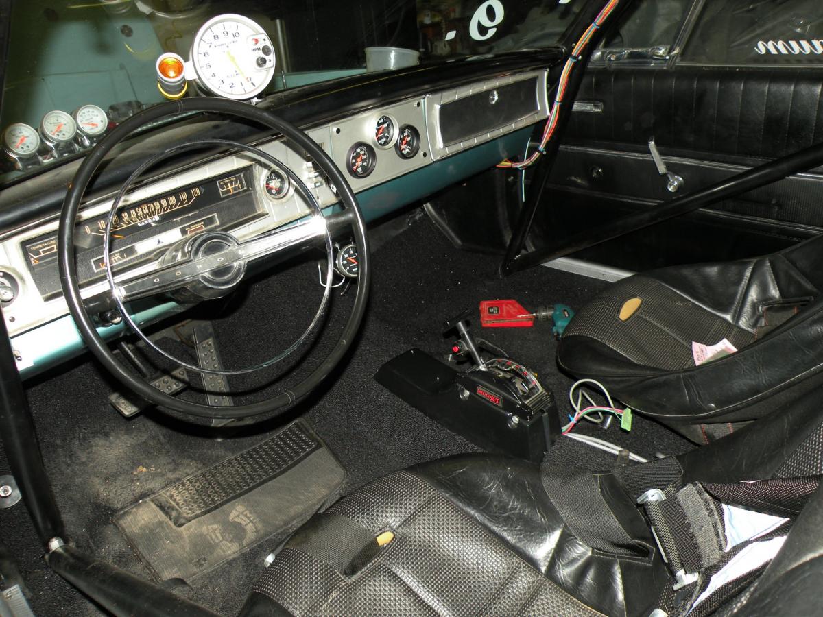

my mistake, vacuum is 3 inches at idle.
just installed a new vacuum gauge under the dash.

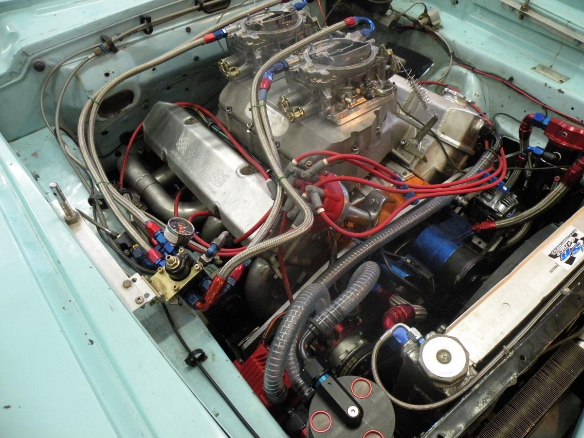

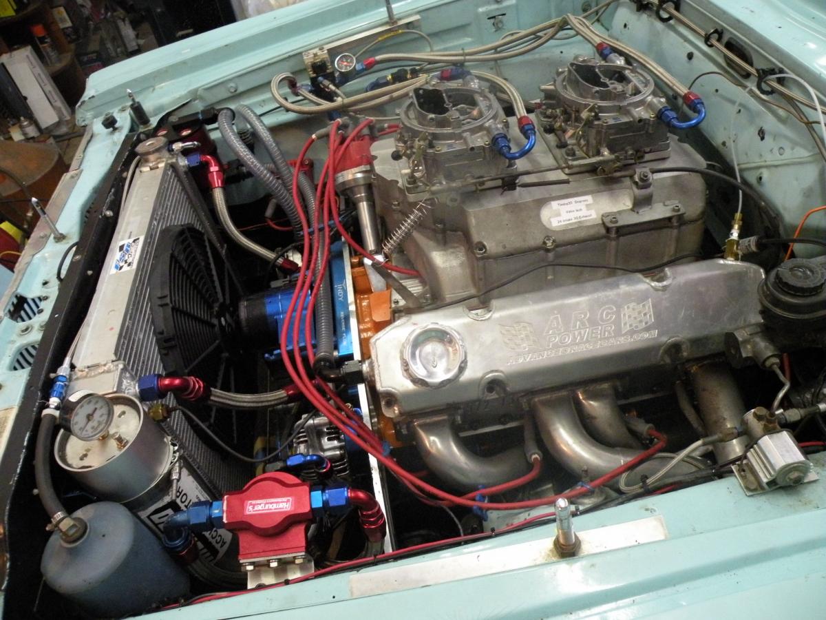

How do you like that reverse flow water pump? Does it come into the engine from a single outlet from the lower radiator connection the up to the water pump "inlet" connection?
I really like it alot. Reverse flow cools heads 1st. Got the 2 lines coming from opposite ends of the top part of the radiator. I don't like it that way. Asked my engine builder why he did it like that. I wanted the top 2 lines to enter on the passenger side top on 1 side. He says it will be fine this way.
I ran it this way for 2 seasons with no problems and it runs very cool.
