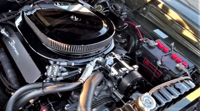

I purchased from AutoZone
Here it is installed - I removed the DieHard labels, added Mopar & red caps
