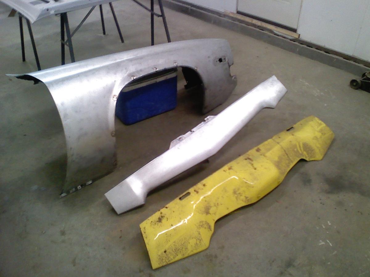

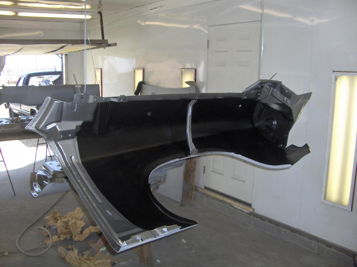

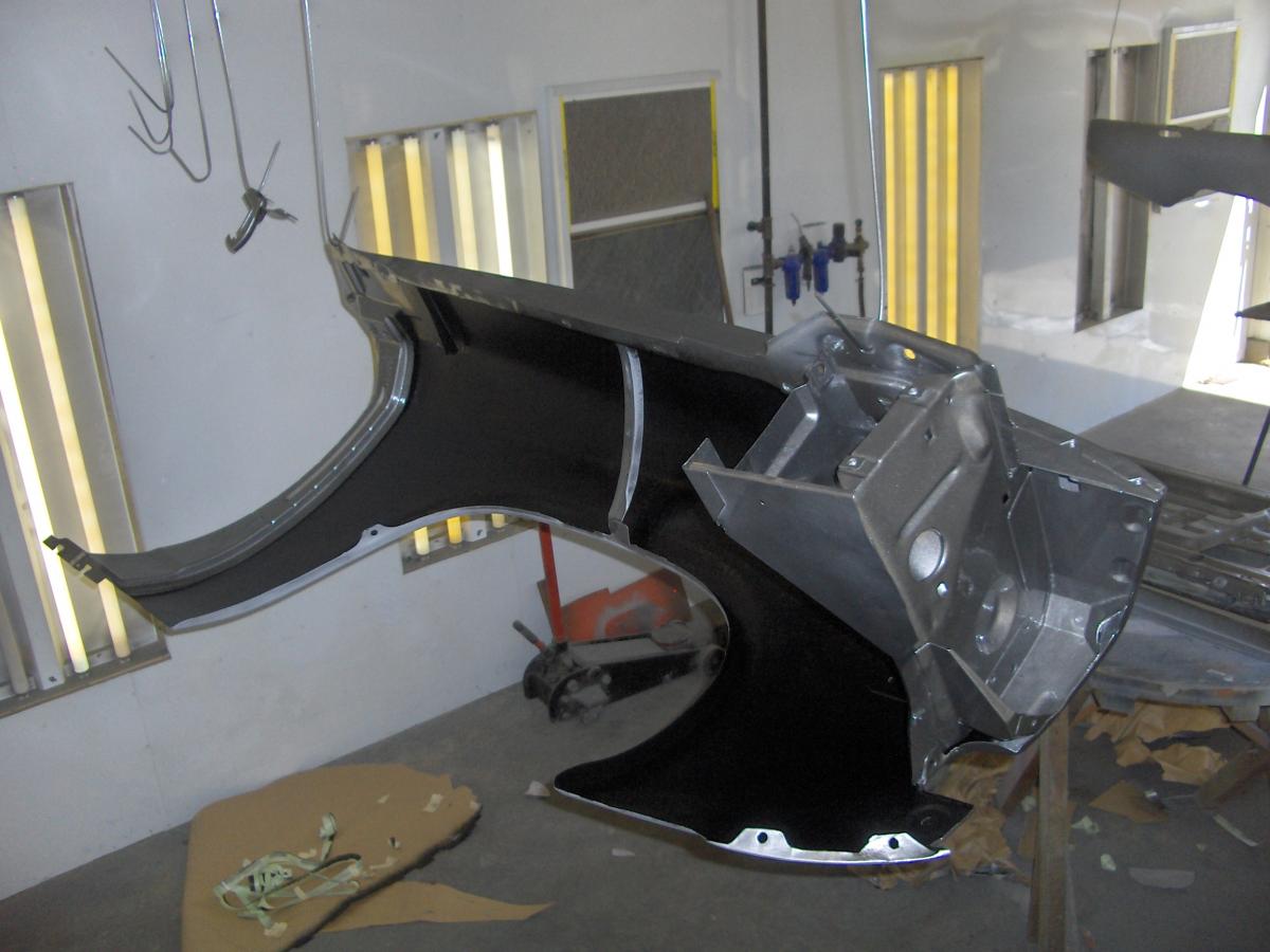

I did mine with a grinder wire wheel and some metal conditioner on the indide and just sanded the out side down,I have a blaster but didn't want to chance it.I think they came out ok....see pic's
They came out very nice. Is that silver paint/primer or bare-metal? I wonder, how many hours you got in those fenders? If you have the time, then you win!
The first pic's are bare metal the last to are Silver paint then I used some black under coating on the inner fender. I put 10 hr's in on 1 fender and the headder panel.
