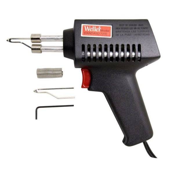

    Those were never the "Mack Daddy" unless all you solder is huge wires.... Most of the stuff I solder that tip will hit three components at once....

      Well, most of us didn't solder what you soldered back then....the key words being "back then".
      Perhaps I should have added the qualifier "Harry Homeowner" or "anyone but an electronics service guy" Mack Daddy....
      Point being back then, most of us either bought the garden variety $3 stick soldering iron (and dealt with that things' aggravations) or sprang the big bucks (I think maybe like $12!) for a Weller at the Radio Shack....and yes, a variety of
      tips was available for them, including sharp-pointed ones.
      They got hot fast when you hit the trigger, yet didn't stay juiced all the time.

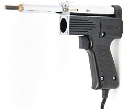

                I guess it all depends on what you are soldering. I like, and still use, an old Weller 100 watt gun, with the replaceable copper tips and 2 small light bulbs, with on-off control. It works great for electrical and electronic works. For precision electronic work, like printed circuit boards, a small chisel point low wattage (20-30 watts) soldering iron works best for me...it just takes a little longer to heat the joint. I also have a low wattage DE-soldering devise that vacuums the molton solder away ftom the connection point. BTW...use only a small diameter ROSIN CORE solder for electric and electronic work NOT acid core. I've used Ersin Multicore solder for years with great success. Unfortunately, tin-lead based solders are becoming hard to find, especially for soldering copper water pipes. And silver based solders need special fluxes and very high temps to work.

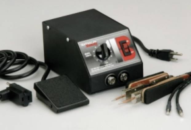

                  I have a Weller pencil iron and the gun. For almost all automotive stuff, you can get it with a gun. I also have a resistance soldering station for delicate stuff.
