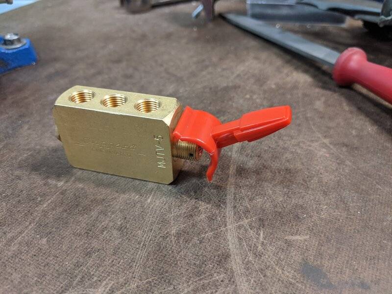

I started by buying a Clippard MJTV-5 4 way valve with 1/8" NPT off of Amazon for $31.88. This is the type of valve you want because it has 2 outputs on the bottom and one always pulls air. The center hole you see in the pic is the inlet and the other two are exhausts.
Next I shaved the handle on the valve to press fit the plastic handle like the original.
Note: Not pictured here, I shaved a little plastic off of the top and bottom of the red handle so I could fit it further onto the toggle.
I then added brass hose fittings that I also got off of Amazon for $5.09 each. They are 1/8" Male NPT x 1/8" Barb.

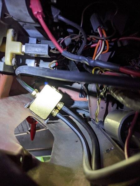

I had already cut the hole for the switch in the original location as well as the plastic dash cover. Naturally this won't work with the new valve so I cut 2"x2" piece of metal I had laying around to cover the round hole. Drilled a hole in the center to fit the new valve through, attached the valve, put the plastic dash back on and test fitted several times before I locked it down.
Attach the hoses behind the dash (the top hose was a little tricky).
Then, assemble for the final time and test. In my car I have 12in vacuum at the manifold and when I tested each hose at the actuator (scoop open and closed) I still have 12in vacuum. No more leaky switch!

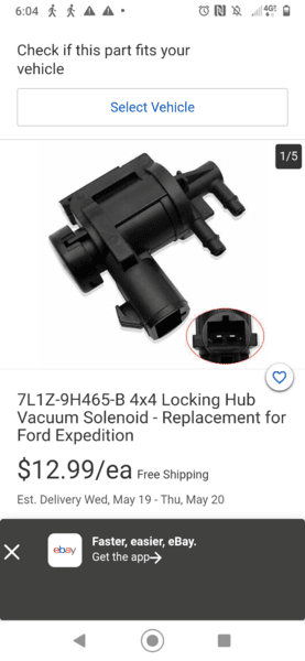

When I was putting my Charger together I didn't want all of those hoses going through the firewall so I used solenoid actuated vacuum valves. Ford used them to actuate their 4WD, readily available just about anywhere.

My application may differ because in my case it was for opening the headlight doors. In my case the high and low beam wires were used to trigger relays both for the headlight relays and the solenoids, since both high and low beam activate the solenoids I had to use diodes to prevent backfeeding one to the other. Since they require vacuum to open and to close I used two vacuum solenoids, one wired to the normally open contacts and the other to the normally closed contacts on the relay which are only powered with the key on.
I'm pretty sure I did a thread on it or put it in my build thread, I'll look for it later.
