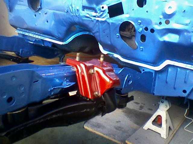

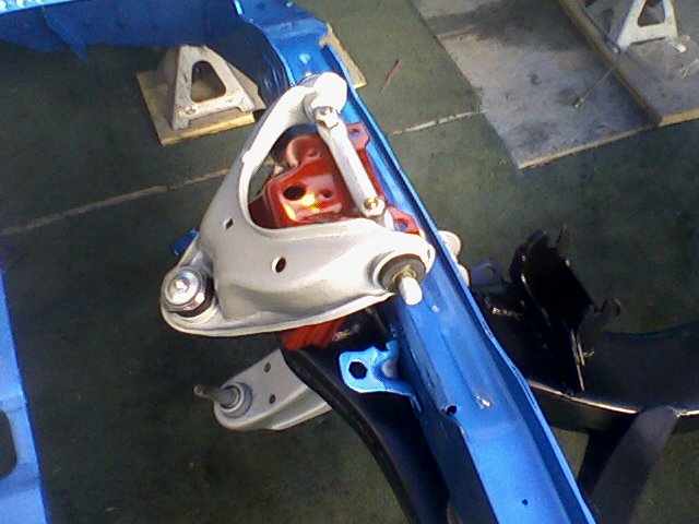

too many to count lol , that plate painted red above, has two adjusting stands poking up through it, those have to be in position before the plate is bolted down. that's what your uca attaches to and thats how you adjust your camber/caster

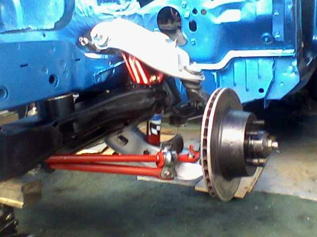

So some "idiot" removed every part of my entire front suspension a "couple" years ago (engine/trans/K-member not removed), and now he can't figure out in what order to re-assemble.
The car is a '73 Road Runner. Frontend is on jack stands.
This "idiot" sandblasted and painted and/or RPM (Rust Prevention Magic) every piece that could rust.
This "idiot" figured out how to remove/reinstall the bushings in place for the LCA arm using a Harbor Freight press, and even figured out how to weld a strengthening plate to them.
This "idiot" has Firm Feel's tubular UCA.
This "idiot" even removed and reinstalled the rear torsion-bar cross-member and installed solid bushings after sandblasting and painting that piece. "Idiot" even figured out how to install solid bushings on the K-frame, etc.
This "idiot" is armed with all new MOOG suspension bushings, ready-to-go LCAs, ready-to-go spindles, but is confused about what can be assembled/torqued off the car, what can be assembled but not torqued until the car is on the ground, etc. What to do first? Second? Third?
"Idiot" does have a shop manual, full tools, including 250 ft. lb. torque wrenches and compressor and pneumatic tools and even Mopar ball joint sockets, etc.
But now "idiot" is staring at a bunch of parts off the car and doesn't know in what order he should proceed...
So far, he's done this:
Installed the floating torsion-bar rear crossmember using solid bushings, torqued to “only” 35 ft. lbs. at the recommendation of Firm Feel (they aren’t Firm Feel’s parts, but they are from a defunct company called “solidbushings.com").
He's looking at this:
spindles, knuckle arm, caliper bracket, torsion bars, full MOOG bushings, etc.… torque now, or just mate it all up and torque it later? What should go on first, though? Tie rod ends? Pitman arm? UCA? LCA? Spindle?
"Idiot" would prefer someone that can explain to him like he's three, and if it's very detailed, can even thank them with beer/PayPal/etc.
"Idiot" can look up torque specs from the factory manual, and even procedures, but it's difficult when EVERYTHING is disassembled due to the "modular" way the factory manual is written.
"Idiot" is just looking for something like:
CAR OFF GROUND, so…
(EXAMPLE ONLY:)
1. Install strut rods to car at this point… DON’T TORQUE UNTIL CAR ON GROUND ** OR** Install strut rods to LCA and torque to spec, THEN install strut rod to car, but don’t TORQUE until car on ground
2. Install spindle knuckle and torque down BEFORE putting on car
That kind of stuff… And is looking for where to begin...
"Idiot" may be me, but don't tell anyone.

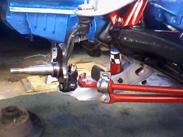

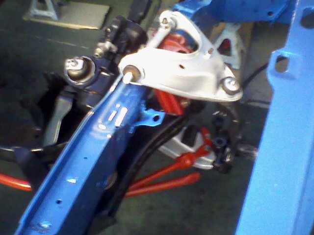

Okay, sorry for the huge delay in progress... I am mostly done, but, on the driver's side, I can't seem to lift the LCA high enough to allow the LBJ bolt to go through it so I can put the nut on it (I could probably but a jack under it and it would go through)... Strut rod arms and tie rods aren't connected just to rule those out... The passenger side installed just fine... I had both LCAs hanging down at time of torsion bar installation. They both raise to about parallel with the floor before I feel the resistance of the TBs and can't lift them any more by hand (from like a 45-degree droop to 0-degrees when I lift them up). Do you think when I installed the driver's side torsion bar, it wasn't hanging down far enough? I am sure the knuckle arm is installed correctly on both knuckles. Both LBJs installed fine, seated flatly, torqued to 125 FT LBS. with no issue. Very confused...
I remember when I first got into cars that I would do a drum brake reline ONE wheel at a time so I could look at a brake assembly together to see how to put it back together..LOL WE all learn and have learned by our mistakes...….
I should add that I have Firm Feel's tubular UCAs installed. Maybe rather than bring the LCA up, I should remove the rubber bump stop on the UCA and bring that down. Didn't have to do it on the other side, though, so not sure if this is the right approach...
