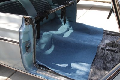

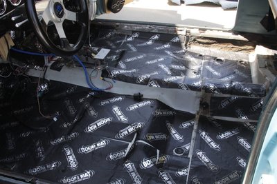

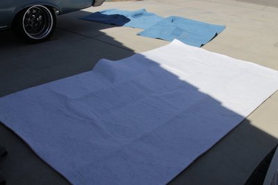

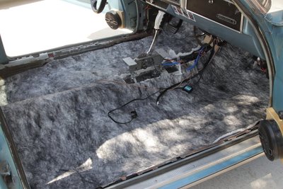

I had some insulation I've been putting off for a not-so-ridiculously-hot day, and yesterday was not as bad, so I installed Boom Mat, Under Carpet Lite, and fresh carpeting to the Belvedere.
Turned out pretty nice!

Yes where did you get the carpet? Looks and forms much better that most I have used or seen. Great job!
Thanks, it took about 3 hours for the Boom Mat, and another 6-7 for the insulation and carpeting - with plenty of water breaks in between.
The Boom Mat and Under Carpet Lite are from DEI, it comes as a large sheet, and I simply laid it in and cut it to fit. The Boom Mat doesn't need to cover the entire floor, as the curved sheetmetal doesn't create resonance.
The carpet I got from ACC - I've always liked their quality on replacement carpet.

Is that cut pile? And did you remove the gas peddle then reinstall?

I did loop pile for this, just seems to be more period correct, I guess. And yes, I removed the gas pedal, then once installed I cut the bolt holes only for the gas pedal and placed it in the holes. Then I marked the inner lines with blue tape and cut the recessed area.
Interesting to note, the last time I installed ACC carpet, the floor pad was right where the gas pedal is, and I had to cut into that plastic pad. This time, I couldn't push the carpet up enough to reach the base of the pedal, so I'm glad I waited until I installed the carpet before I marked it and cut it.
It's also a good thing to note that you can't forget to cut the holes for the seatbelts. I did... and did a Tim Taylor "Oh NOOOOOO!" when I realized it. lol

I will say this about them, the people there can be jerks. I talked to one guy there and he was an ***. I ordered mine from Rock Auto. This is one product that I almost didn't buy because of the person I spoke to there. If you buy from Rock Auto, they'll take care of you. I wanted to buy it without the insulator pad, you can only get it that way directly from ACC. After talking with the guy there, I decided I would just pull of the insulation myself, which I did since I used the Under Carpet Lite from DEI.

How much boom mat did you use? 10 squares?

I used about 8 pieces per side, including remnants for the trans hump. They tell you that any part of the floor that has compound curves doesn't need Boom Mat, so I kept it to flat panels for the most part. When we did a car with that 'other stuff'... they provided a kit and had us cover every square inch of the interior, both door inner panels, and quarter inner panels. I think that's way too much. I ended up with some leftover even though it was a "complete car" kit. I haven't done the trunk area and will likely to that with the leftover.
