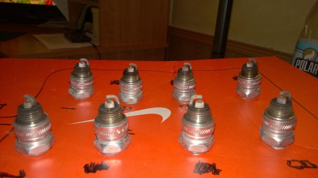

Here's the spark plug pic:
They're the usual Champions with just a few hundred miles on them.
I don't see anything to warrant concern here. If there was anything drastically/mechanically wrong, they'd show it, right?
Y'all know a bunch more about this stuff than I do. All I know is right now, after all this work, my baby is a beached whale in prime summer cruising months!

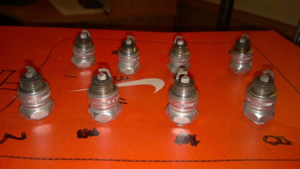

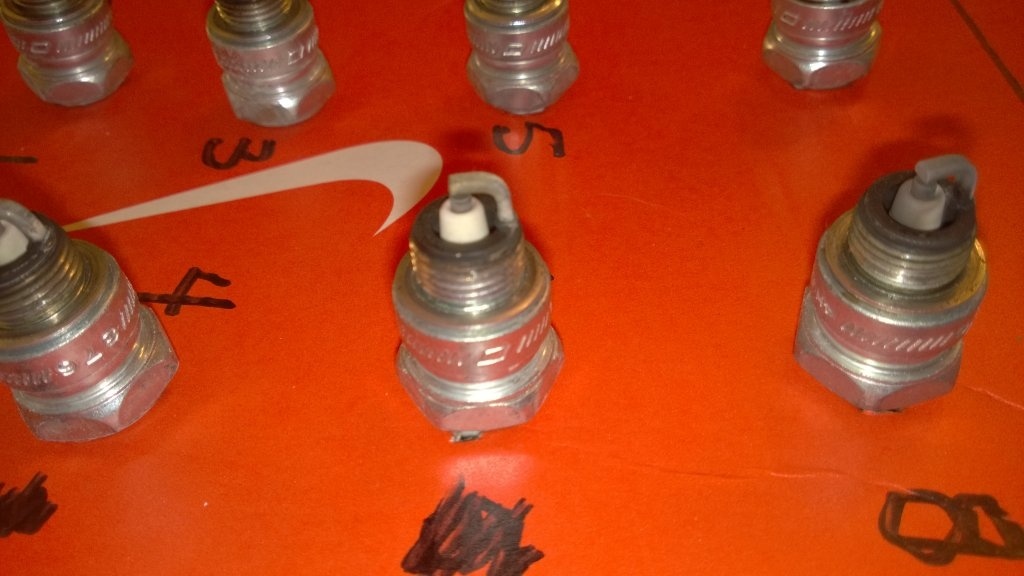

PS - #5 looks really clean in that pic, so I spun it and took another:
Plugs look decent Ed, that extra qt of oil will only help you find a leak :lol: or cost you a couple or three HP win you spin it up.
Myself I would start at the basics and while its doing its ruff idle start pulling plug wires one at a time to try to locate what cyl is miss firing.
If the plug wire test does not produce , check the carb for something affecting the idle circuit. vac leak, ect.
Back to the dizzy check voltage readings ect, cap crack ? rotor fried ? I cant remember ed if you still are running points, mabey a little grease on them and a burn spot now ?
Good hunting my friend. :thumbsup:

looking at the straps i think there may be too much timing,.....? plugs are dry, that's real good.
Thanks, what I'm hoping too. Figured if a cylinder was having issues mechanically, I'd see it on the plug?
What does the other side of 6 look like. The side shown is to clean compaired to the other 7. Does that plug fire?
It's definitely the cleanest of the bunch. Wouldn't it be soaked if it wasn't firing, though?
Depends on the amount of time it sit before the plugs were removed.
You said it has had a recent compression test. Was that before or after the problem developed? Maybe a good time to check 4, 6 & 8 again. Will give an indication if something has happened to #6 and if low would support fuel wash.
Not sure why it would only affect #6 now and not before but with a plug that clean at also may not be getting fuel and show signs of no combustion.

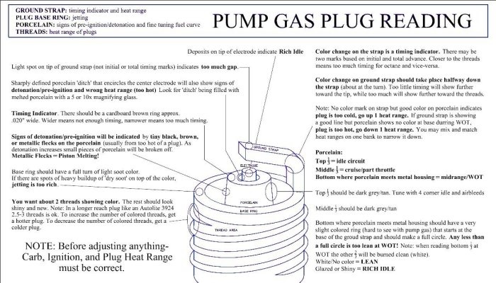

Also,next time you change the plugs,go one step colder as they look hot. You would like that coloer change to be in the elbow of the strap.
