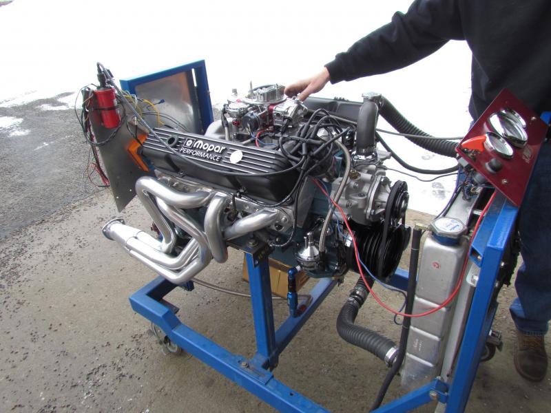

The guys that built my engine dented the number 2 primary for that same reason. I have the performer RPM heads and 1 7/8 Hooker Competition headers as well. IMG_0458.jpg
Thanks mate, that's the exact problem I have, if the header design was the same as the left side it would be sweet. I have dented the number 2 pipe slightly but I think I'll try shorty plugs and better plug wire insulators
