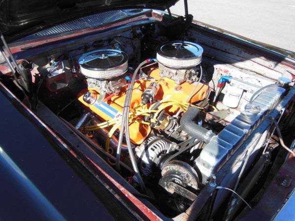

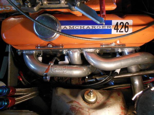

What headers do you have? Maybe a picture of the one giving you fits.
2 on the drivers side,,and 3 on the passenger...hedman race headers..there 1 of the better fitting headers I have used..no dings were required to install..and there going to stay that way..the ceramic boots should cure the problem..reading some of the feedback from others on that link,theres some mopar guys with 440's there that swear by them..

View attachment 534070 View attachment 534071
If you have no intentions on wrapping your headers or providing additional clearance, the ceramic boots are practically your only option. Good luck, hope they work out for you!

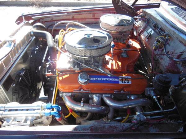

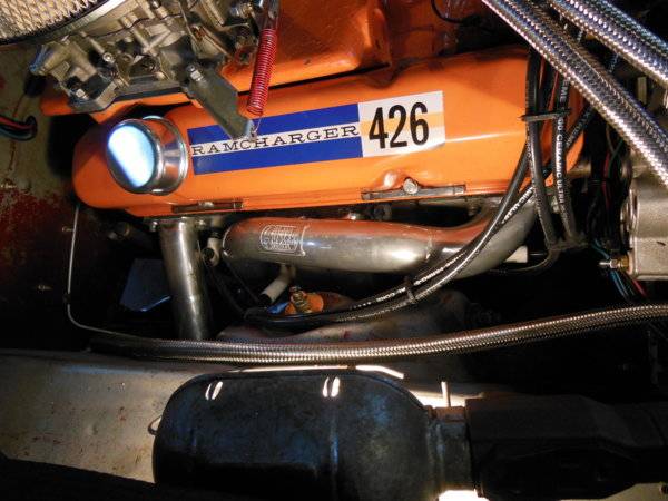

great!just installed them today..tight little suckers..had to use spark plug wire assembly lube to get them to go all the way on the plugs..but these wont burn.now as long as they don't crack and create a grounding point, should be good to go..cleared all header tubes..the tightest one was #6..it may be touching the tube barely...will run it tomorrow..
