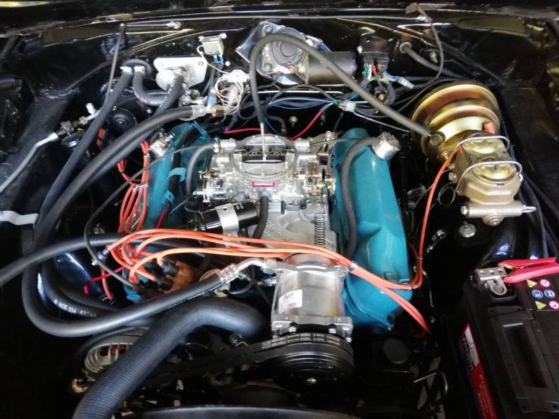

Dear all,
Struggling a little bit with the length of my spark plug wires from Mopar performance as they are just too short to route them without getting into contact with TTI headers.. and missing some seperators to route them along
Engine is a 1970 383
Any recommendation on which ignition wire set gives enough length to route 3/4/7/8 along the heads and from the backside to the spark plugs? and which seperators to fix it? (most prefferably something i can also find on summit due to best shippinh costs to europe..)

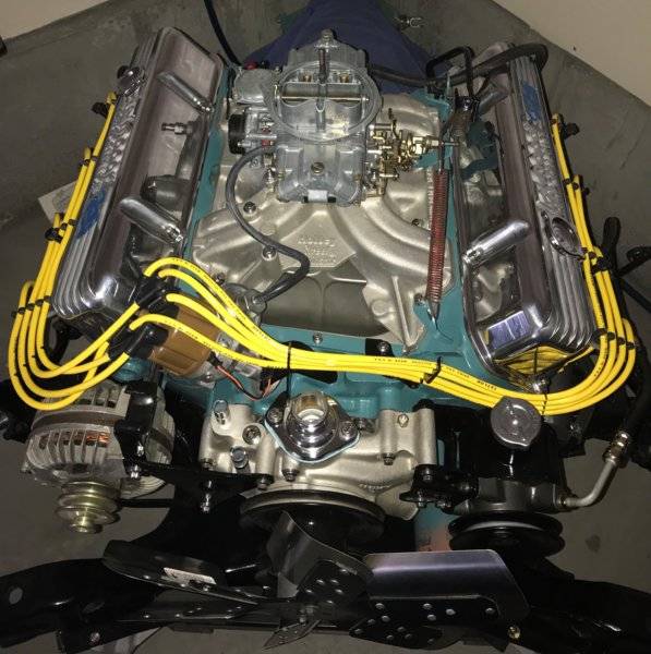

Had to go MSD on mine and make custom wire lengths with the straighter style boots. I also run the ceramic sock style boot protectors to ensure they don't get hot and burn.

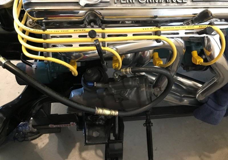

Taylor 8mm Spiro-Pro 135 boot cut to fit wires (#73453). TTI headers. The wire looms are Mr. Gasket with custom brackets.
I went with Mallory 135 ceramic custom cut to fit with R&M billet looks and Taylor loom supports as fill in.
