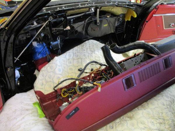

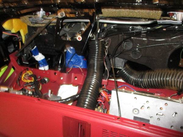

Gettin ready to install my dash assy as a complete unit, but not sure where to position the speedo cable to get it lined up with the incoming dash....did a 4 speed swap too, so now there is clutch stuff in the way...any pix or ideas? Cannot remember where it was originally, (from 25 years ago)....68 charger
If it does not have AC it is not a big deal to run after you get the dash in.
Attach just before the cluster is set home. Give just enough hand room to get it done.
If I recall, there is a retainer tab on the lower inside frame rail near the torsion bar, to hold the cable... I think ... my ancient brain is mush
Thanks for the replies, but I need to know where it should be positioned.....In the steering brace, above it, below it, left, right...etc...no A/C....it will suck to have to reach up there and move it once the dash is in....I have big presidential hands....lol!
It goes between the pedal shaft and housing. Then through the steering brace opening....
