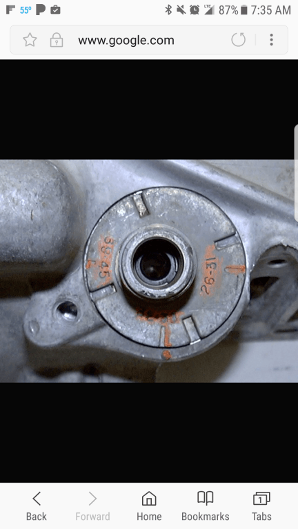

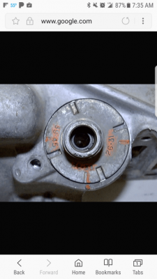

If you look at this picture you'll notice the cable inlet is off center, this is to accommodate different gears for different gearing and tire diameters. The clamp fits into the slots and holds it in place once adjusted. I just spin the housing while turning the gear until it engages then line up the slots and bolt it down.
To remove just take out the 1 bolt and C shaped clamp and pull it out, it's sealed with an O ring.

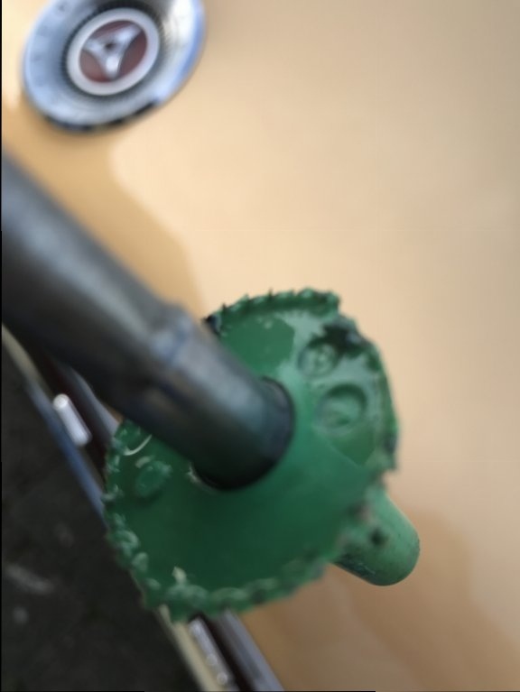

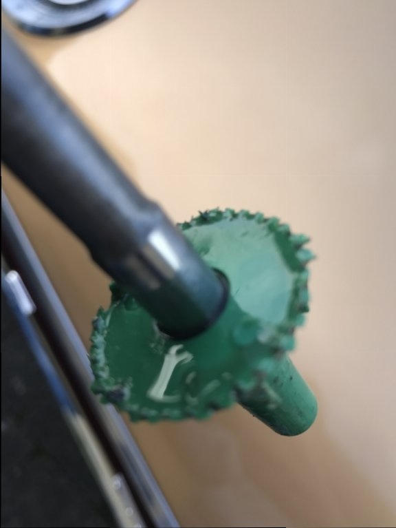

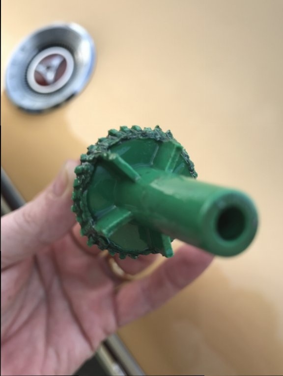

Either the cable is broke, gear isn't meshing (not adjusted properly), where the cable mates into the gear could be wiped out or one of the gears could be stripped (both plastic). Shouldn't be hard to figure it out.

Might want to find the rest of that gear first lol, not good to have floating around in there. I'd say something is either bound up in the cable or Speedo or it was never set right to cause that. Good luck
Yeah it was installed and set to the wrong tooth setting no wonder it stopped working, do you really think I will need to get into the tranny to find the bits of plastic?
The speedo is making an intermittent noise now that its working, its like the numbers are getting stuck or the cable is catching on the back of the speedo, spooky noise if that makes sense, so I might be better to just replace the cable anyway?
If you don't clean it those junks could get into the teeth of your new gear and wipe it out. They may settle into the pan and cause no trouble at all too but the pan magnet won't ever hold them in place so they'll always be free to move around.
