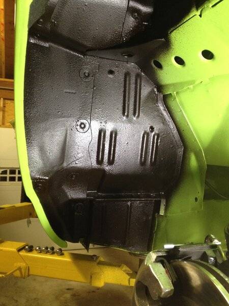

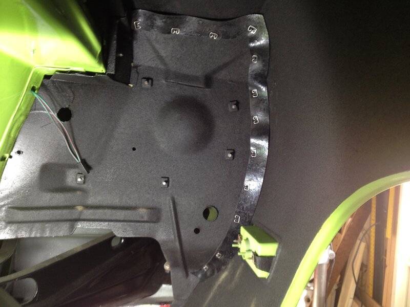

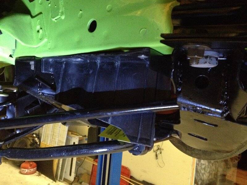

How many splash shields are on a rr/satellite? I have the two rear and one for transmission. I know the front fenders have them, not sure what they look like though. So many more are there?
Here are a couple of shots under the fender of my 70 Road Runner.
Hope these help.
Hawk
2 up front on K member, that rivet on I think.
Here is a shot of one of them. Note that there are a lot of slight differences in these for different models of cars - I found they are not all the same!
