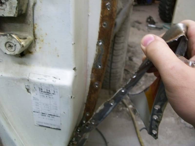

this is the one i used it did ok

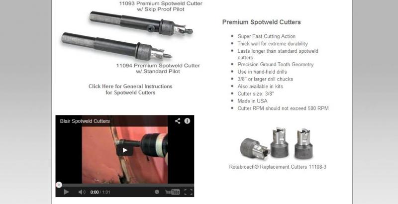

Blair all the way Ron...you won't look back. Both the skid proof and the spring loaded pilot work great (helps to use a punch with either). Buy their cutter lube or use a machine cutting oil/penetrating oil with them and you'll be drilling out spot welds like a champ. This is one tool you definitely do not want to go cheapest price shopping on (same for most tools for that matter). Makes a world of difference having a quality cutter vs. a Bargain City Sunday special.
http://www.blairequipment.com/Spotweld_Cutters/Spotweld_Cutters.html

Blair is the best like Will stated. I drilled out 1 or 2 welds on my Charger project and wont use anything else.

When you drill 10000000000000000 welds a year like me then the Blair Rotabroach is the only one. Just like Propwash says.

+1 for Blair. Works awesome, just make sure you get the premium rotabroach or better yet the little kit they sell. The cheaper double-ended ones don't last for $#!+ as youd probably expect lol
