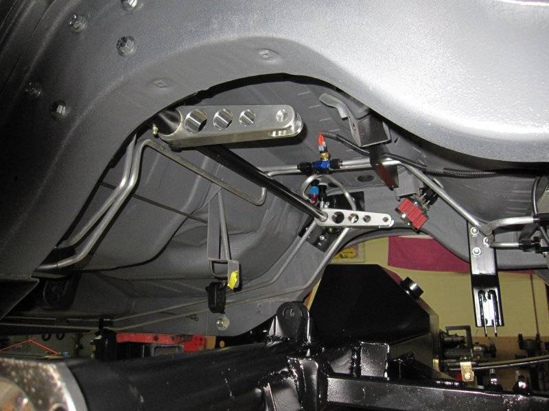

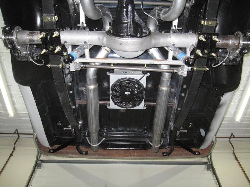

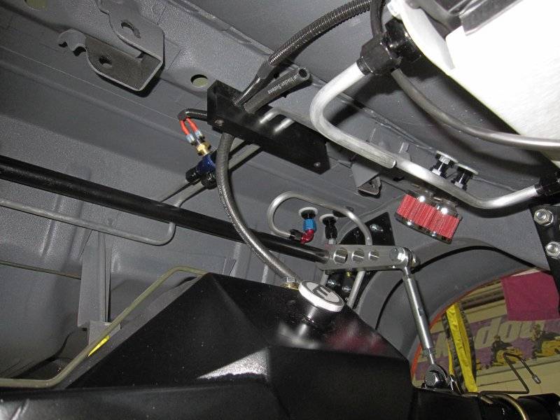

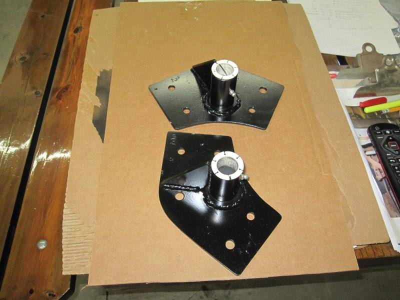

I used a Competition Engineering (I think) drag race bar in my 65. I fabbed bolt-in brackets to make it a bolt-in install. Don't have any idea if it will work for corners (it should) until I drive the car.

That looks awesome. Exactly the kind of set up I'm looking for. Don't have an extra set of those brackets laying around that you want to sell, do you? Lol
Thanks! One set seemed like enough but, some cardboard and 1/4" plate will quickly get you a set. Happy T day!
Mike

I kind of figured that would be the answer. Lol Thanks for the help and the pictures. Hope you had a good Thanksgiving and have a Merry Christmas.

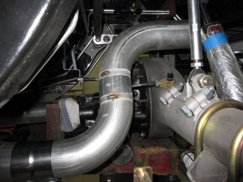

I'm in the middle of trying to figure something out too. The problem I'm having is that a bar that mounts to the frame like Mike's above, is that the brackets occupy the same real estate as my exhaust. I currently have a hotchkis rear bar but it will no longer work with the springs narrower. If I could only find a bar that style that's about 32" eye to eye I would be set. Buuuuut, almost nobody publishes their dimensions
My 3" tailpipes clear fine. Of course, my fuel cell is not in the way.

There are all kinds of universal kits out there that you can make fit. Not exactly like Mike's, but with some cutting and welding you can make it fit. Some are a two bar set-up.
