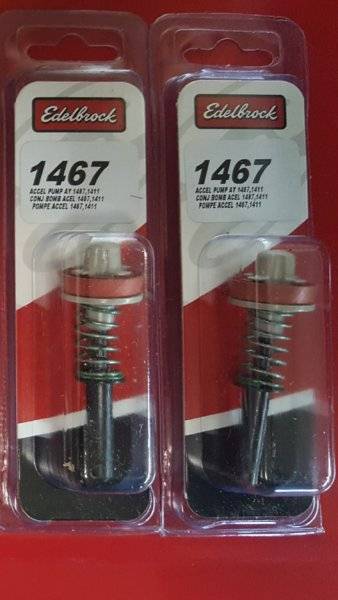

If you have the blue accelerator pump, get rid of it. Use the 1467 instead. The blue one that came in the rebuild kit didn't last 100 miles.

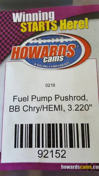

3.220 is what your fuel pump push rod should measure. Use this one if you have a regular cam, not for a roller cam.
