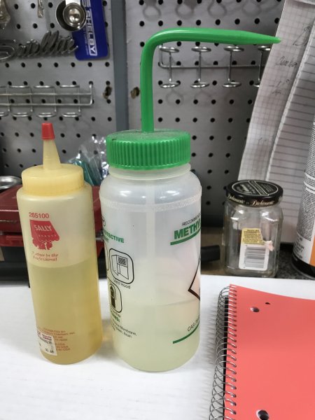

Ethanol evaporates very quickly out of vented fuel bowls. Holleys - Carters - doesn’t matter. They all have ventilated fuel bowls. I use these to prime the carb after it sits for several days.
As an alternative you can get in, don’t touch the gas, turn the key for about 5 - 6 seconds, pause, crank 5 - 6 seconds again, and again, then pump the throttle fully 3 or 4 times to prime the engine and set the choke, pause a few seconds to allow some vaporization and then turn the key to start the motor normally. I just personally don’t like to spin a cold motor ove4 this much so I prime.
I just personally don’t like to spin a cold motor over this much so I prime.
Yup. Exactly why I went to the mustard squirter, like yours on the left. I changed the starter a few years ago, I'm not burning up a starter due to crap gas.
