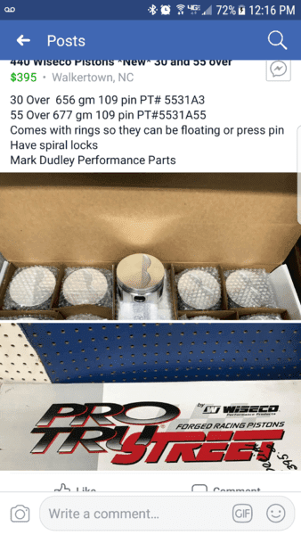

There's a guy that has the Wiesco pistons on FB selling complete set of .030 & .055 NIB for $395....
He might be a member here. .

The SRP's are a great Piston ! No doubt about that, but for Nitrous using ANYBODY's Forged Pistons, you need to go with a 2618 Alloy, which in this case are reserved for the higher priced "JE" brand itself.
Same goes for WISECO(2618 alloy), and their cheaper line "Pro-Tru" (4032 alloy)
