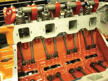

That’s not a conversion head. I tried to buy them new a few years back and was told they don’t make them anymore. I’ve posted on this site looking for a set with no luck. Here’s a conversion head on a wedge block.
That’s not a conversion head. I tried to buy them new a few years back and was told they don’t make them anymore. I’ve posted on this site looking for a set with no luck. Here’s a conversion head on a wedge block. View attachment 1241418
Damn, my customer is going to be severely disappointed. Is there any other companies that did this in the past? Otherwise, we're looking up dressing up a gen 3 hemi as a Gen 2 and putting that in there but I don't think he wants to do that
