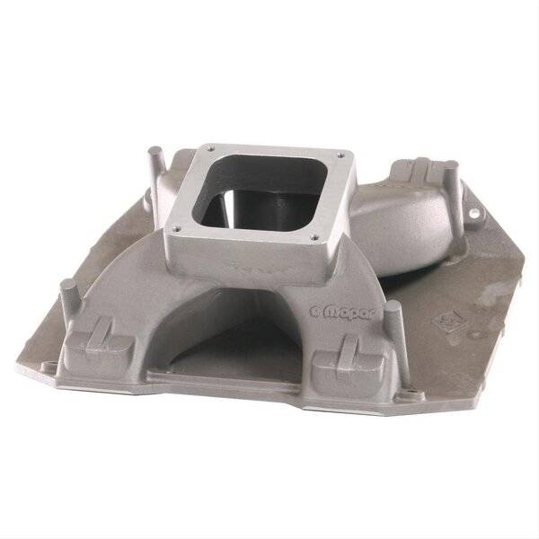

It they're going on an RB block, you’ll either need to use one of the dedicated stg 6 intake manifolds, or an RB intake with the spacers.

Just keep in mind, like I said previously, any intake other than a dedicated stage 6 manifold will need spacers be used between the manifold and heads, if you’re using an RB block.
They’re going to be about 3/4” thick.
MP used to sell them....... might be able to find some if you dig around.
Just keep in mind you’ll need the MW sized version.
Without the spacers , the mismatch will be the same as trying to run a 383 manifold on a 440.
If you go the spacer route(as opposed to the stage 6 intake), my preference is to mount the spacers to the heads, and port/flow the heads with the spacers in place.
The two MP stage 6 intake part numbers(the number in the catalog and on the box......not to be confused with the number cast/etched onto the manifold) are:
P4876128 for a 4150 carb
P4876129 for a 4500 carb
After doing a little digging, it appears as though the part number P4876129 intake would have the number “P4532758” on the manifold itself.
The P4876128 has number “P4532757” on it.
