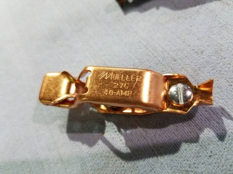

Has anyone run into this problem?
I bought one and it has no "spring" to it.
When pushed onto the tubes it does not spring back and is loose on the tubes.
I'm wondering if I just got a bad one with incorrect tempering or something.

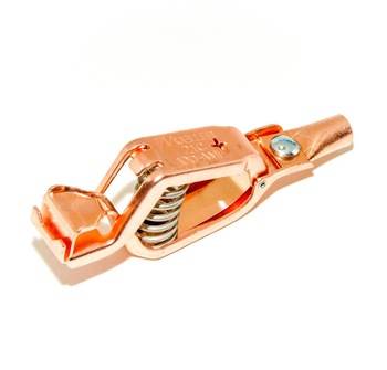

I pulled a photo off the internet.
Looks like this.

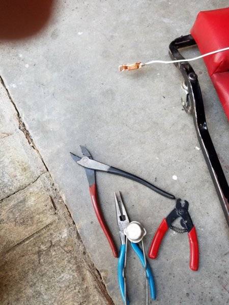

I've got a stock one, off my 64...same problem, guess it's wore out. Got tired of messing with it.
Left it on the workbench, and ran a strip of 12 gauge wire...works.

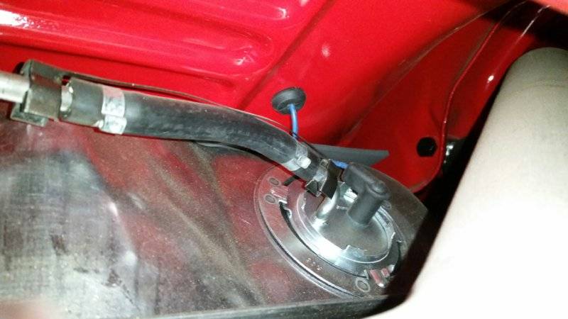

The problem with worm clams and wire is access.
Have to work by feel and very little room on the tube between the sender body between and the hose.
Mad working the clamp and hose and didn't realize the stainless fuel tank was sharp till I got out

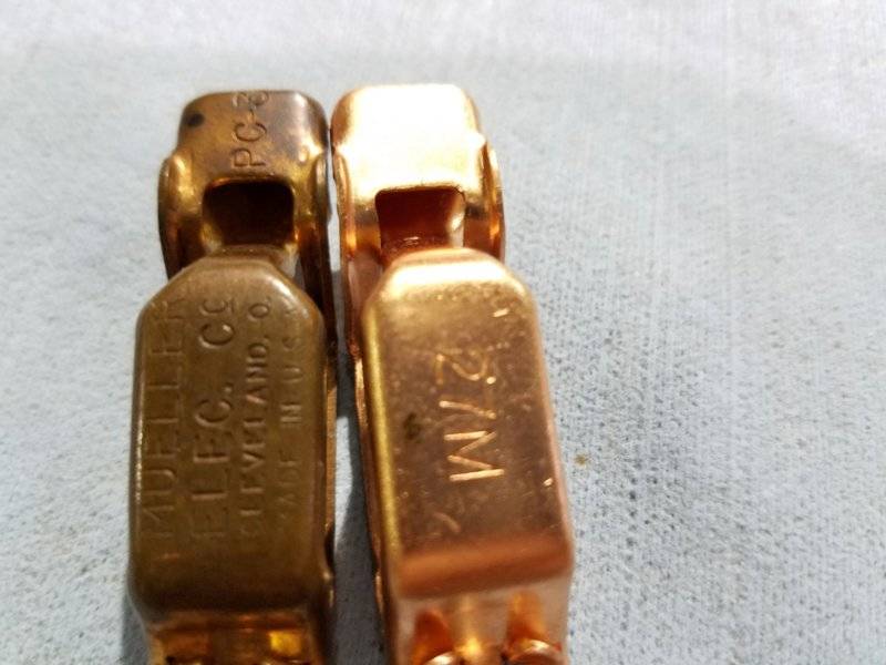

Stainless by nature is very hard from the manufacturing process. That is an inherent problem with stainless. The original metal style is a much softer material which can be bent to conform to the profile of the fuel line yielding a better ground. Add to the fact that the original style as pictured is very short which makes it more difficult to work with. Chrysler I believe in 72 superceded the earlier part number with a longer variety which was twice the length which made it easier to get a better ground for the sending unit as well.

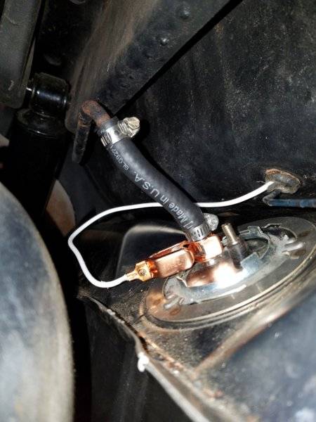

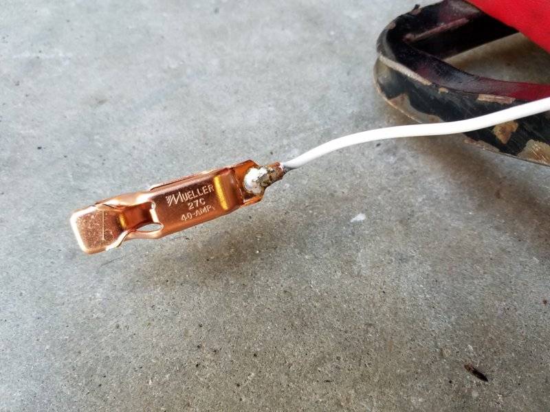

Works like a champ.
Claimed "Marine".

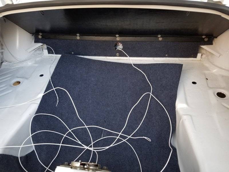

Tinned Teflon wire to a ground stud in the trunk.
Crimped at the support and soldered.
Did not use the screw.
Check out the "double" grounding. (Tank and trunk)

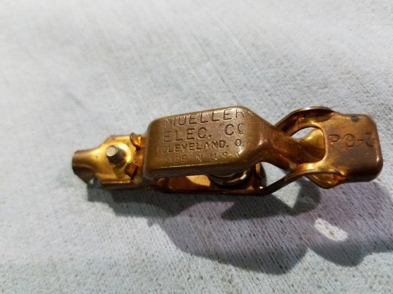

My 30 year old stock of clips was getting low.
Found a good price.

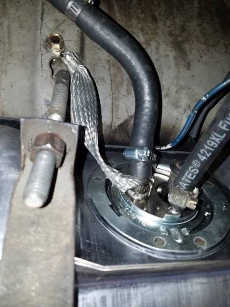

Here's what I did...clamped some braided ground strap firmly to sending unit nipple and then attatched to body...flexy and a solid electrical connection..
