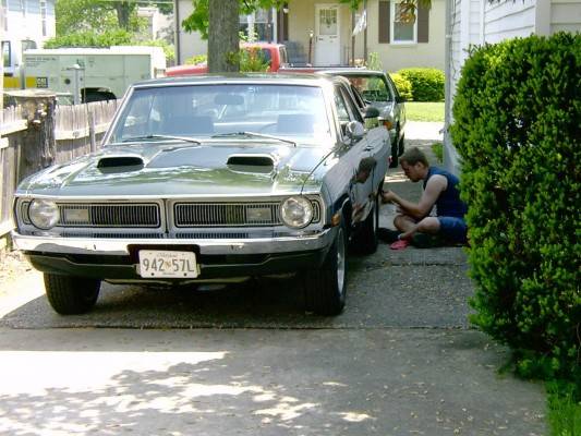

We ran the old 284-.484 cam my sons old 383 combo. It was mild 383 with 452 heads with mild bowl blending. The heads were cut for 9.5 comp with the stock pistons and bottom end. Used the RPM intake and a 750 DP. CPPA Headers and 3" pipes. Had a turbo Action converter 3000 stall and 3.91 gears. Car weighed 3550 with him in it. Ran a best of 12.31 @ 110 on McCreary G-60 tires. I used the stock dist I curved for total timing by 2000 rpm and the orange ECU. It really ran good with that combo. Here he is cleaning off some rubber on the 1/4's. Ron
