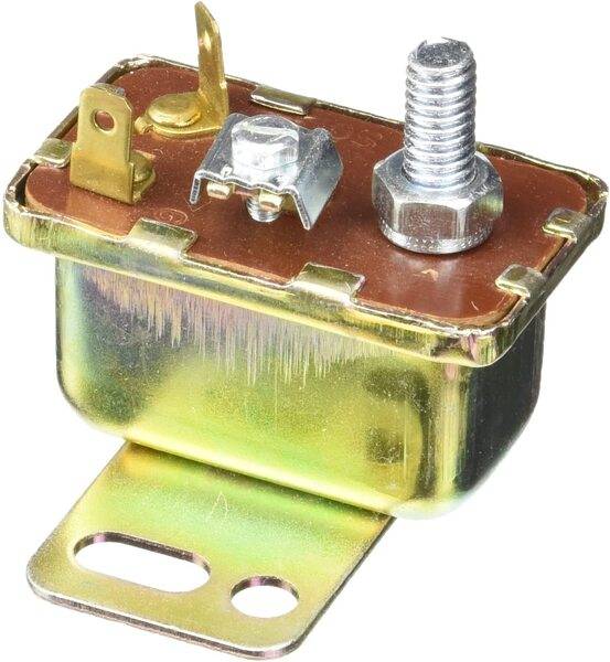

the one he has looks like this...... the 2 brass color terminals are "I" and "G"...no "S"...... middle one is heavy guage (10?) to the starter
maybe it isn't the same as ours?
The two spade terminals should be marked. Ignition and ground.

yes they are......and its a 318...... someone's abandoned project..... I suppose I'm not even sure if it's the correct relay, it's a bit of a clusterphuck

Reason I asked is you will have to have a neutral safety switch to complete the ground for the relay. As far as a keyed 12 volt wire its anyone's guess as it is not much Jeep anymore.

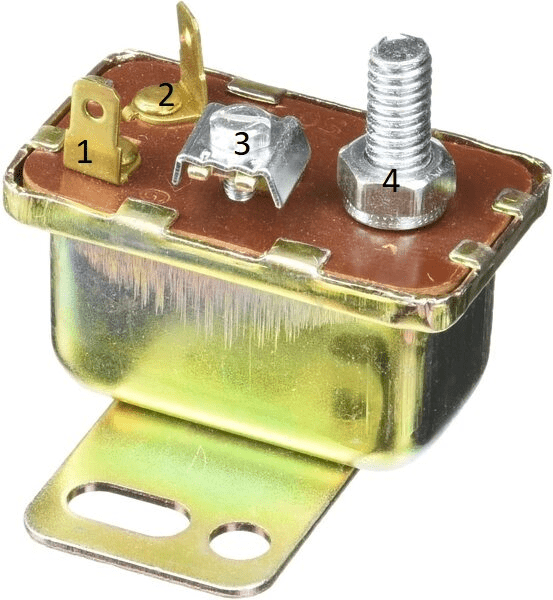

Terminal #1 - Ground or to the NSS
Terminal #2 - Ignition source
Terminal #3 - Supply to Starter Solenoid
Terminal #4 - Main power in from battery/to dash via fused link etc
(Variations on that exist) :thumbsup:

"ignition source" ........ you mean 12 volts from the ignition switch in the "crank" position, correct?

Yes, that's correct. The reason that #1 is usually Ground/NSS, is because it is parallel to the outer face of the relay case, and there is usually a molded plug that fits snugly over the edge of the case to secure the positioning.
#3 should have a fork terminal - or can be a ring terminal....just don't lose the washer('U' clamp) and screw if removing for a ring terminal. :)
