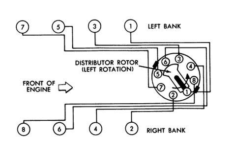

I rotated the balancer to TDC “0” and put my distributor back in and the rotor is now about 7:30 to 8:00 position…..if I understand correctly this is the #1 spark plug wire which it is showing me on the distributor cap….Is This Correct….please let me know…..
If everything was installed the factory way, with the slot on top of the oil pump driveshaft near-parallel to the crankshaft centerline (front-to-back), the #1 tower is closer to 5:00 when looking toward the driver side--
**With the rotor pointed directly center of tower#1, the ignition timing will be at
0°....it MAY not want to fire up and run with no advance.
There's two things you can do:
--Twist the distributor CW as the engine attempts to start. If you don't have a remote start switch you'll need a helper.
--"Static time" the engine. This is where you set the damper somewhere between 10°-20° BTDC, and then point the rotor at the center of tower #1.
I prefer the static time method, but either way a final timing adjustment will be required once it's running, to get it back to where you want it...
It is to my understanding that the #1 plug wire is in the 7:00 to 8:00 position from factory….I never took the distributor drive gear out…..my past mechanic set it up and it ran fine….I’ve seen some post that said the 383 came this way….the #1 plug wire lines up with the rotor in the 7:30 position now …..the way I rotated it on TDC “0” on the balancer it can only go the way it is or 180 degrees opposite which I know can’t be correct….I’m no timing expert….that’s why I’m asking the forum guys to help me out….please advise me if the setup I have now will work…. Thanks, Steve
