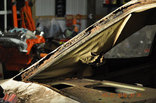

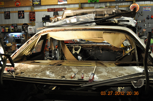

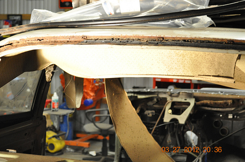

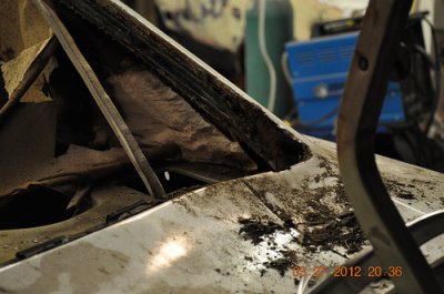

I removed the rear window tonite and this is what i found. Now im trying to figure out what do to. I am totally lost. I dont have skills to pull something like that off or to replace with a new complete roof. I do have new AMD full quarters and dutchman panel. Any comments, advice, or anyone with any donor cars for sale?

man that is bad.other than putting on a new roof,i would be at a loss on how to repair that.hopefully you can find a good donor car maybe.
Yikes.....Well looks like it's time to roll up the sleeves and tackle the challenge.
On the positive side, those new quarters are going to come about halfway up the c-pillar. Also, you can buy reproduction lower window corners from AMD. Not that expensive. If the rest of your roof is good, I wouldn't waste the time or money changing the thing out. Myself, I would take a ton of reference pic's and measurements. I would cut out cardboard templates that matched the angle of the lip coming down into the channel as well. Make a cut that follows at the transition where the vertical plain of the roof 90* down into the window channel and across the 90* down from that, in the rotten areas, cut strips of 20 GA sheetmetal to replace the rotton, shape and test fit...Start a Tac at one end, then the other and work down with a tac every few inches till it's fit into place. Once in place weld all along the top transition and where in 90*'s again in the window frame area....That would be my game plan by seeing your pics. No need to get down in the dumps about it. As long as you can weld and cut sheetmetal...You can do it!! Go out there with a "I can handle this" attitude, maybe grab a cold one and spend some time thinking about the steps you're gonna take to knock it out. Alot of us been there in one way or another. Just gotta grab the bull by the horns!
No need for a new roof or a donor car. That rust is not that bad. Just cut it out and patch it. Its mostly flat metal some will probably need 90* bends or a slight curve. My Challenger is the same way except way way worse and I didnt have full quarters or a new roof skin. Cut out some templates and tackle it one hole at a time.

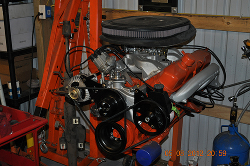

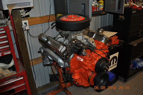

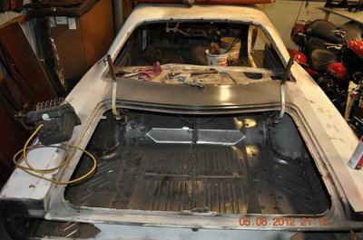

This is pictures of the motors for the 69 and 70 birds. I know the new trunk floor in the 70 has nothing to do with my 69 , just thought i would show i have been busy, not just on the 69.

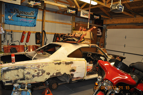

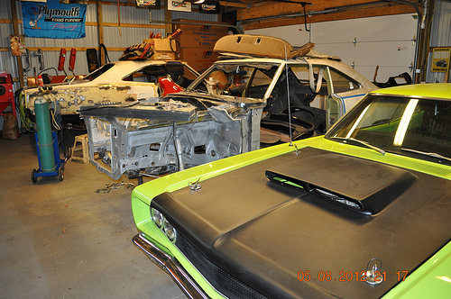

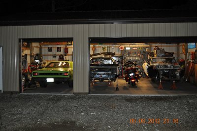

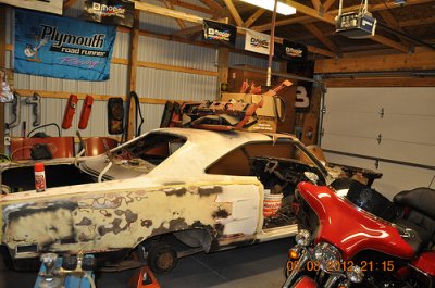

Just a look from outside the garage from left to right 68 bee, 69rr and 70rr. Oh yeah, the Harley then the 70rr. lol.
