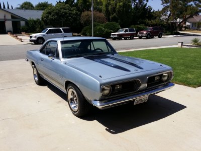

As you can see in the subject box I haven't started fired up my GTX in over a year (Due to illness) I intend to pull the oil pan, and give it a good cleaning. Is there anything else I should due before starting it, and what grade of oil should I use? I was planning on putting in Valvoline 10-40. I live in So.Ca. and we get some pretty hot weather in the summer. The motor is a built 440 with 10 to 1 compression. Thanks for helping!!!

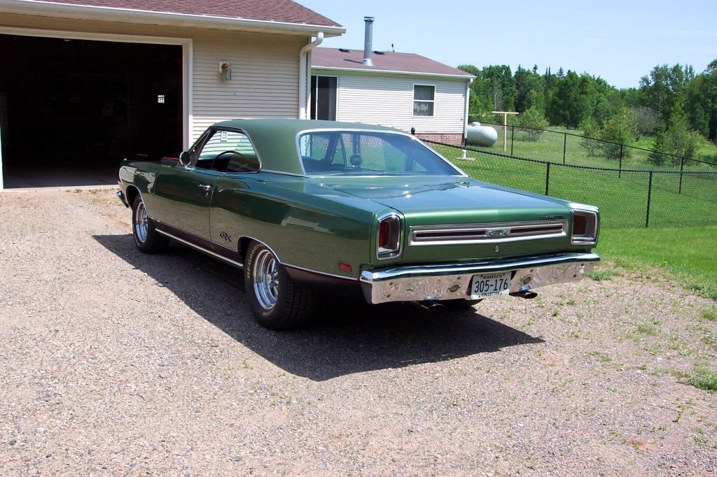

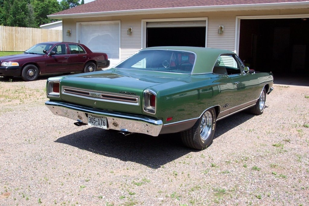

Thanks for teasing us with one pic! More pics PLEASE!:xscuseless:

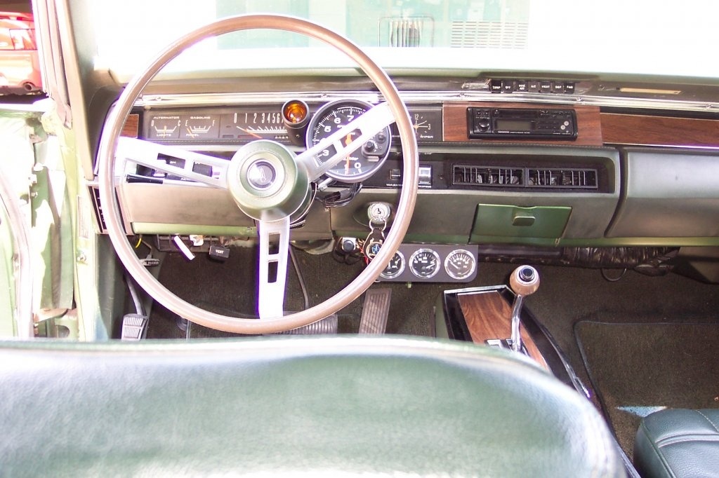

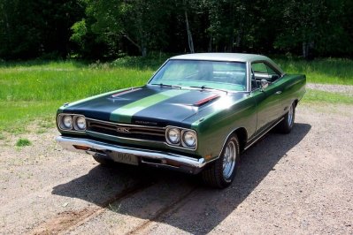

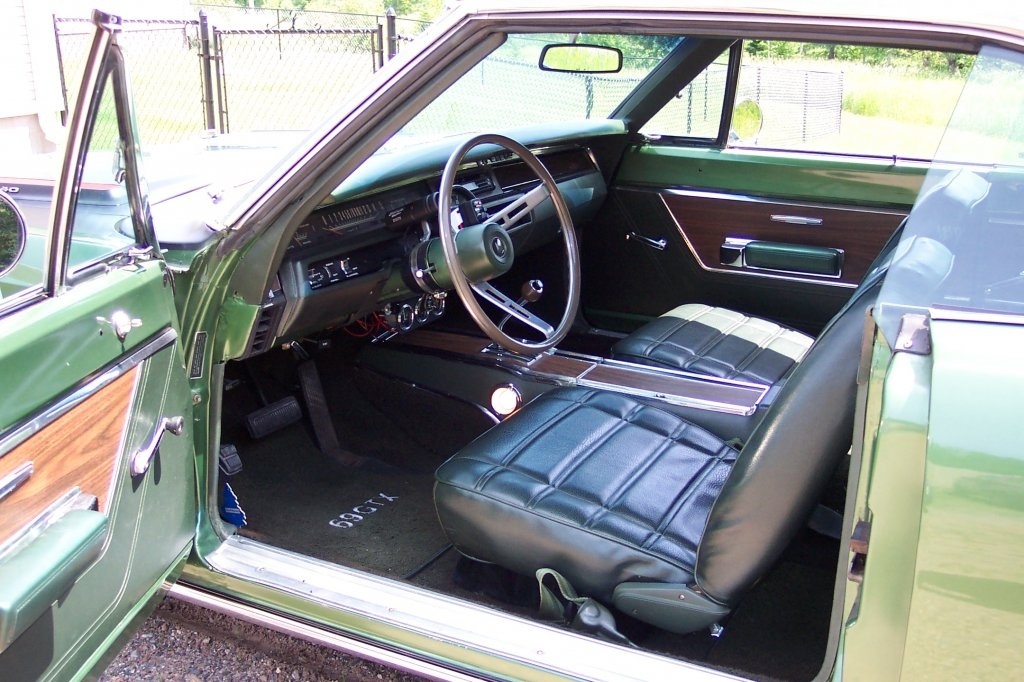

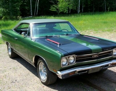

Thanks for the pics. Gorgeous inside & out ! And, what tops it off for an ol' skooler like me, are the cragar wheels, column tach, & gauge pod. And, most importantly, hope your convalescence is going well, and you're feeling fine.
