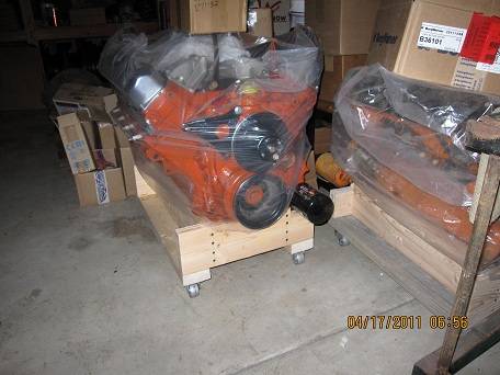

I let my 440 sit in my cold storage garage for almost 18 years. Cleaned the dual points, prelubed and filled up with fresh fuel and fired it up! I had rebuilt the six pack years earlier so the carbs were dry. Later that year, I managed to run a 12.68 quarter mile in my wagon. Now days the engine sits in the cold garage just in case.

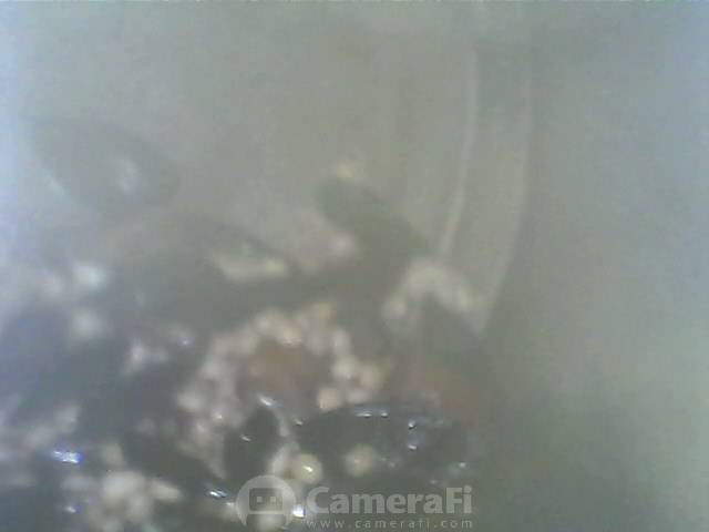

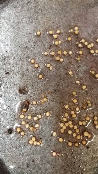

My street car sat for 10 years. Solid lifter cam. Pulled the plugs and oiled up the cylinders. Pulled the intake to inspect. Checked valve lash. Number 7 lifter was sticking in the bore, Zero lash. Pulled the pushrod and lifter and got it freed up. Went to suck the oil out of the cylinders with a hand vacuum pump. Found some white beads in #3 when I emptied it in a pan. Got the cell phone camera out and stuck it in the plug hole. Found peanuts, sun flower seeds and, and bird seed on top of the piston. Cleaned it out. Fired right up. Yes the oil left make it smoke a few seconds. No it didn't oil the plugs. Ran 11.07@122 a week later on the same plugs
