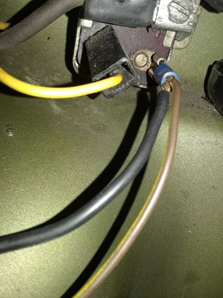

Ok, checked the black wire that is also hooked to the brown wire, and it IS hooked up to ground. Is this the "rig" that makes it start in any gear? Here is a pic of the starter relay and wire connections.
So when the trans is in park or neutral, the brown wire is grounded thru the neutral safety switch in the trans? Is that how the neutral safety switch operates?
I'm going to guess that somebody fabricated that in there as the switch might have failed. Disconnect and see if it starts. It shouldn't. Then hook it up and disconnect the black from ground. If it starts properly, the black was redundant. If it doesn't start, the switch is toast.

I have disconnected the brown wire, and it won't start. Haven't removed the black wire yet, as I can't see where it is grounded, but will do that soon. I suspect that it won't start once I disconnect the black rigged wire. Which would mean the trans switch is bad, or the wiring to it, or poor connection. I intend to check the trans switch with an ohm meter. It should show continuity when in neutral. I suppose it would be the brown wire, and the ground wire. Is that the center one and one of the 2 outer ones? What color would the ground wire be on the connector, black?

About the black wire spliced on to the brown wire terminal at starter relay... it seems the safety ground is being bypassed? Mostly sure is grounded somewhere
Ok, got it fixed! Removed the extra black ground wire, checked the switch at trans and it all works! Hooked the plug back up, and now it will only start in park or neutral like it's supposed to. Learned a few things. Like, the brown wire with yellow tracer goes to the center terminal on the trans switch. Then when the trans is put into park or neutral this wire gets grounded, so the starter will then get power. Also, the back up lights work, too!
It's all quite simple. LOL. On this 1970 Dodge, everything still work's. Pretty much un touched except for changing the 318 to a 440, 904 to a 727, and the 8 3/4 rear end added. I like the cars that havent been modified from the factory too much. Thanks for all your help!
Update: Removed the black ground wire today, and discovered that it was hooked up to a switch that was hidden under the dash. So with the flip of the switch, it could be started in any gear. Not sure why this was needed, but it was in there.
