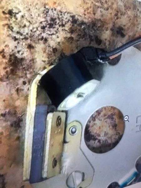

well i was close saying coil issueomg loose coil negative wire,found out the next day right in front of me,It was off the post,and it had a single strand of copper .
and that's why you troubleshoot electrical before fuel.well i was close saying coil issue![]()
Also missing Advance plate spring,and burned failing pick up coil,the black heat resistant strip was melted,you can see in the base of distributor,picture of new pick up with heatshield,,new distributor installed ,problem solved,thanks guys.Happy new years
