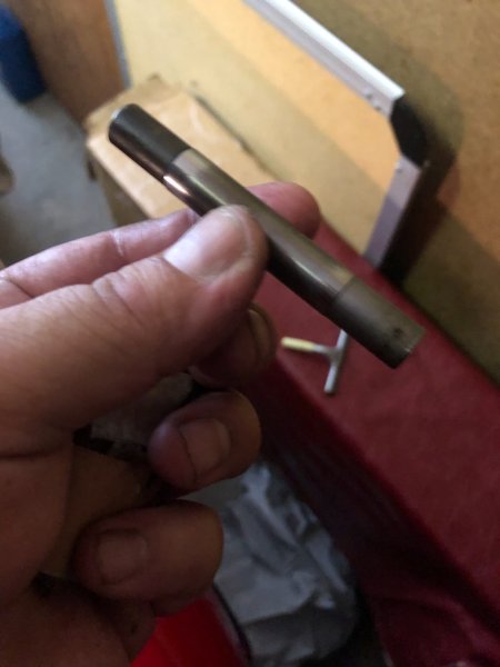

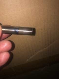

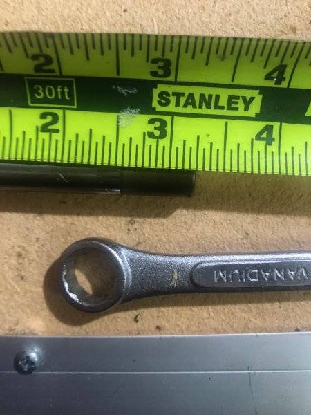

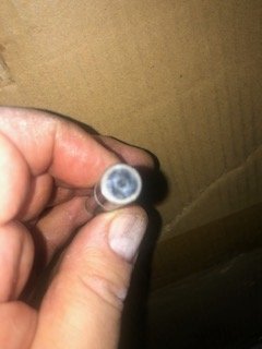

Condition of fuel pump pushrod within length spec? Long topic on this in past comments. Search should find topic
I had one years ago that would go a lot longer. Guy I worked with who was a mechanic in the 60s was the one who figured it out.
Yeah, intermittent problems like that are the worst... coils are cheap (or free) i carry a spare one with me and points dist :) a slightly bad one will work til it gets good and warm then nothing.. wait a few mins and fires back up. a lot of fun
Thanks my friends,,new coil,but birdlover could be right,I changed the fuel pump ,and fuel filter last October,,and I just inspected it,,didn't know about the measurements length,I do now,,,so when I started her,I heard a slight muffled knocking noise near the fuel pump,but it went away shortly after,,I know this could be it,also the carb jet is squirting gas but its not fast flowing,,first time ever checking out. The flow since owning her for 8 1/2 years,thanks again for all input guys.
the ends look worn,is this still good???its has almost 3,1/4 length.Ordered another rod,just to be sure.
