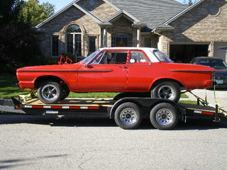

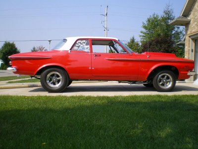

This is what I'm after. This car sits just how I like it.

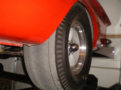

I run Radirs pie crusts on the back. I think they have the best nostalgia look out of all of them.
I found these guys gave me the best price as well. Better than Radir themselves.

You can actually run them on a narrower rim if you need the space. On my altered wheelbase Dart, I ran a 15x7 with the Mickey Thompson, and on my altered Comet, a 15x7 using the Firestone Dragster pie crust. The sidewalls are quite stiff on these, and show no crown or bulge. In some old photos, they even ran these tires on 6 inch rims!! Yikes!!
