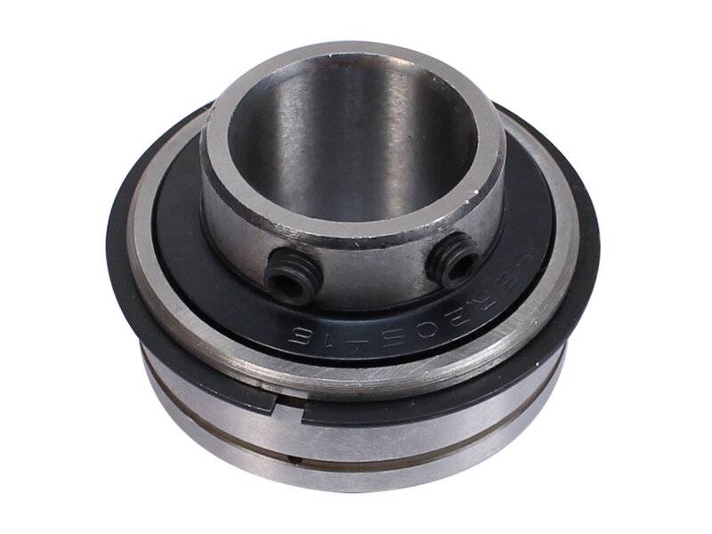

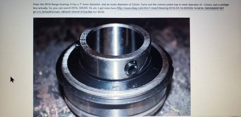

Check out an SER205-16-1 bearing. About $12 on e-bay. I have used a couple of them in place of the OE lower plastic bushing/seal setups. They don't look stock but are alot more solid.
Thanks for the Ebay bearing, just ordered.
Now what about that top one? Mine is toast. I guess I may do the Mcmaster Carr game if someone does not have a Timken part number.

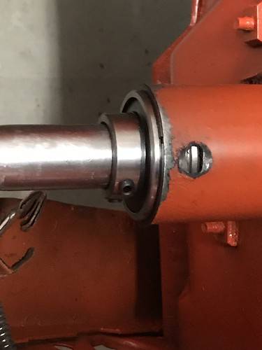

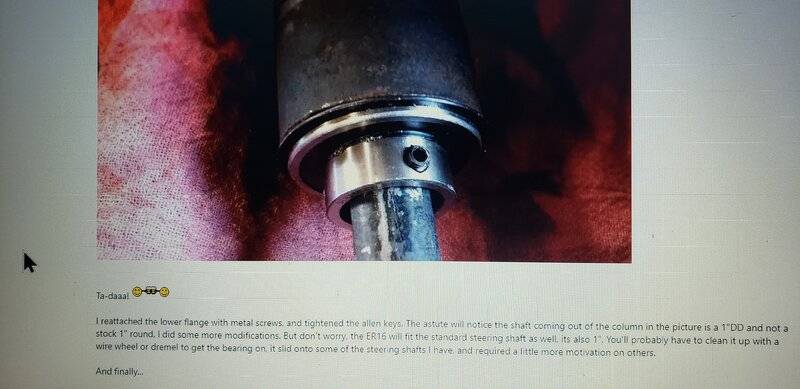

YES! I just ordered mine for $9.00 delivered to my door. 52mm I.D. on my tube and 1" dia. steering shaft.
I'm going to put a spring clip around my tube to keep it in place, but a really great upgrade! Saw the article
on FABO with a Google search. Screw the $100.00 units.
