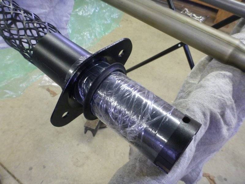

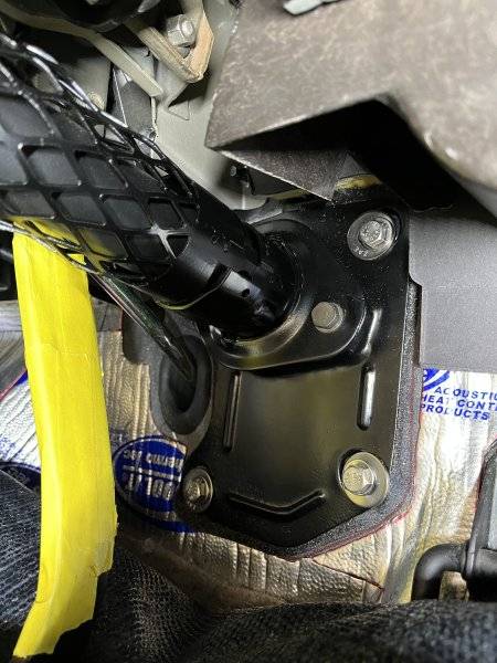

I am in the process of trying to install the firewall plate on the steering column. I cannot get the o-ring compressed enough to get the plate past the two parts that hold the plate in place. I have been trying both a new o-ring and the old one.
Does anyone have any tips for how to get this plate on?
The O-Ring goes between the two plates.
Yes I know it goes between them. I am trying to get the larger plate on that goes against the small one in the picture. I can’t squeeze the o-ring enough to get the other plate past the two points on the column that hold them.

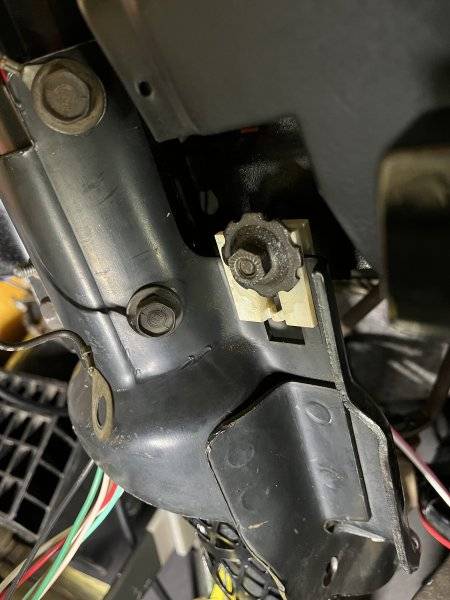

I am pretty sure everything is on the other side of that hump.
So the two plates are on the far side of the humps from the steering wheel?

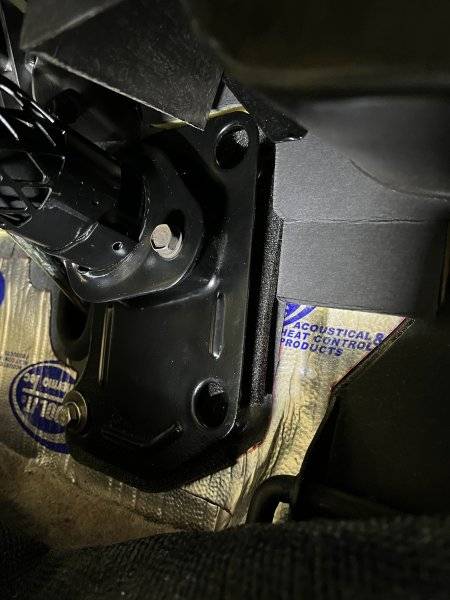

I am thinking that maybe the case. Because I did get them together on the side of the humps closer to the steering wheel. Then when I started to put the column in the car the studs that it mounts to seem to far out of the bracket on the column.
And there is still a gap between the plate and the firewall.
Yes. Going the way you have it I doubt you could get the box coupler at the right depth.
Thank you. I will move them to the other side of the humps. It has been over 10 years since I removed. I couldn’t tell in the pictures I had taken or any of the one I was able to find on this site.
Much better with them on the correct side of the humps.
Sometimes the simplest things throw a curve ball. Pretty sure when I was putting my Charger back together I had the same problem.
It made sense to me at first because the two plates have notch’s to fit over the humps. Thanks again

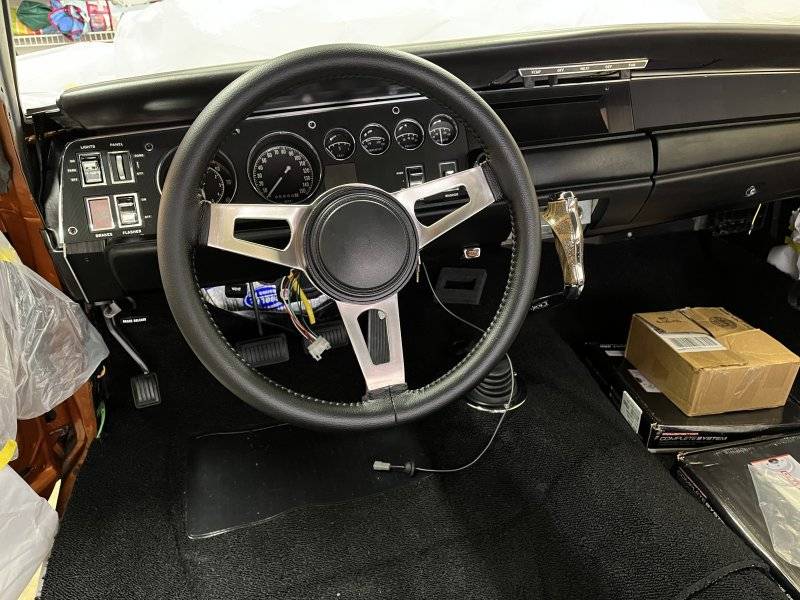

And here is the steering wheel temporarily installed. Needs to come back off so I can install the turn signal lever.
What are you putting back together? I see multiple year parts?
It is a 68 Coronet. It was 440 model that I am making an R/T clone. I know the tuff wheel and pistol grip are not correct for 68.
