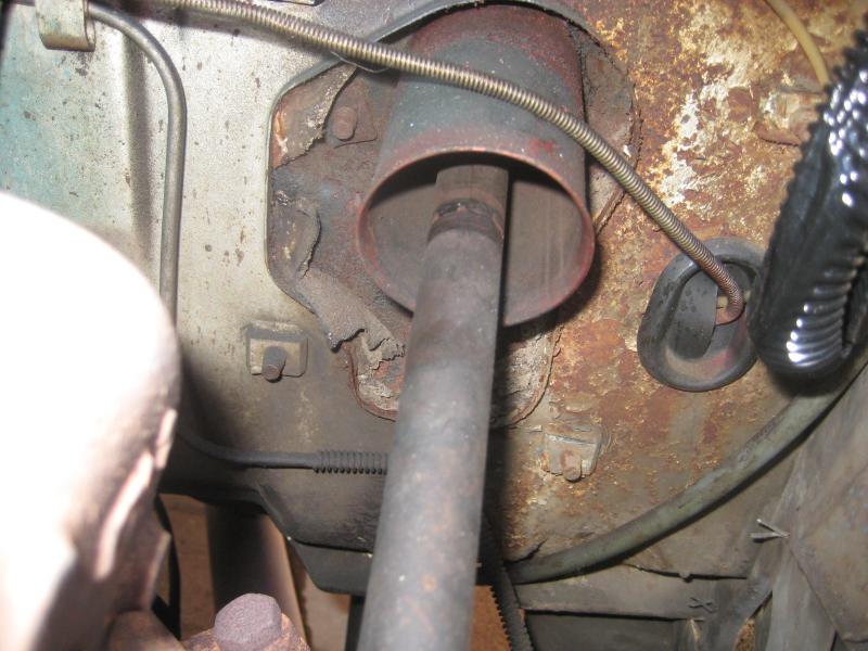

Ok, I need some help on what parts I need to stop the hot engine compartment air from traveling into the car and broiling me alive. Please look at the below picture and let me know what part(s) i need to seal the area between the column and the steering shaft and where to buy them. The air that void lets into the car is unbearable.
thanks,
Detroit Muscle Technologies has that foam gasket that seals the column support plate to the firewall. I'm sure having the oval plug cut for your analog gauge lines or manual choke (whatever they are for) to come into into the vehicle doesn't help much. Maybe seal that up from the inside with a little black RTV or something?
BTW...Looks like you're missing your lower column bearing
so I wasn't clear enough. The area within the red circle had a plastic cover over it. The plastic was cracked and eventually fell off. So I am looking for what goes in that hole/over it and around it. I have a 66 parts manual. But it doesnt mention the charger column. So I dont know if the coronet column with floor shift will suffice.
thanks,

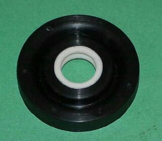

there is no lower bearing on a 66 column....the seal you can get though Mega Parts....for the time being, you can stuff some insulation up the column to stop the heat from getting in.
The seal is around $50 I think..I bought 3 a while back

seal bought and being shipped. insulation will get stuffed in there ASAP. thanks for the tip.

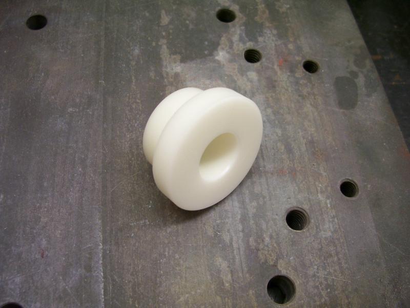

i had some of these made for my '65 coronet. they plug up the hole and support the shaft.100_0286.jpg
