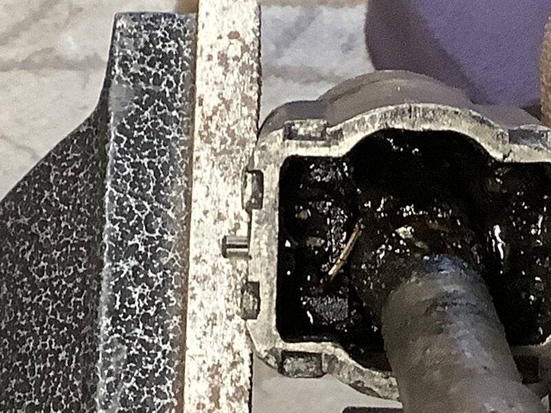

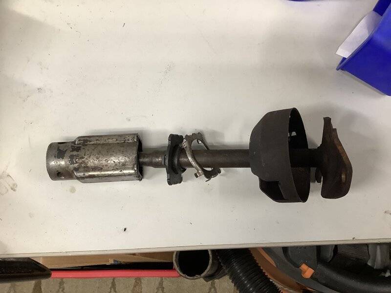

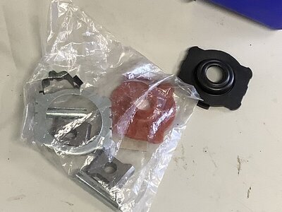

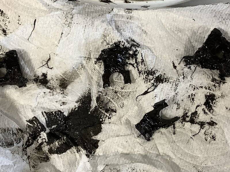

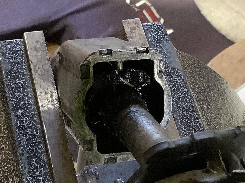

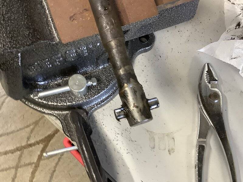

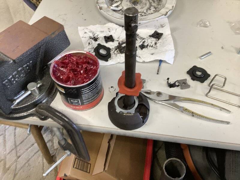

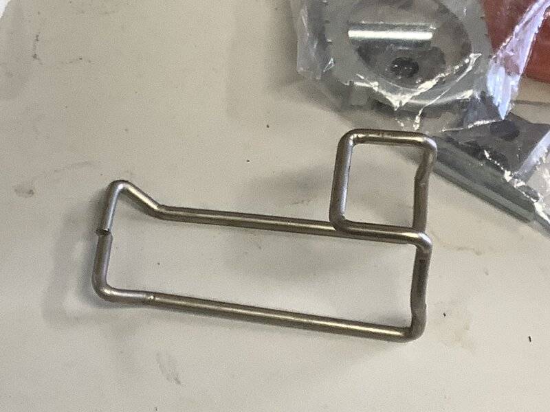

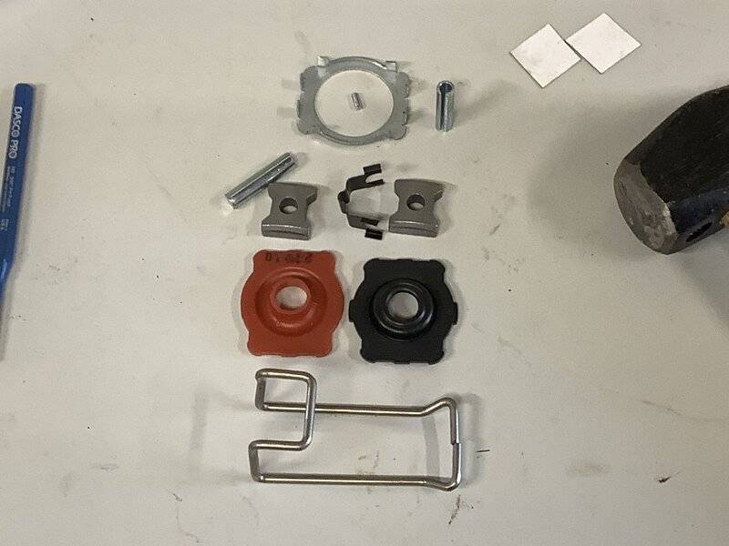

Here’s some pictures from mine that I did just a couple weeks ago. There’s a spring that’s folded inside the coupler to keep tension on the shoes and it’s usually broken. I got the so called rebuild kit and really just used the spring which is not the best quality. The new shoes were wrong size both for fitting in the housing and also too small of a center hole to fit over either the old or the new shaft. Imagine my surprise .:lol:
Cleaned everything out and loaded fresh grease and also added the clip on the outside to keep the lid on. Not too much work and really makes a difference. Hopefully the pictures will help.
